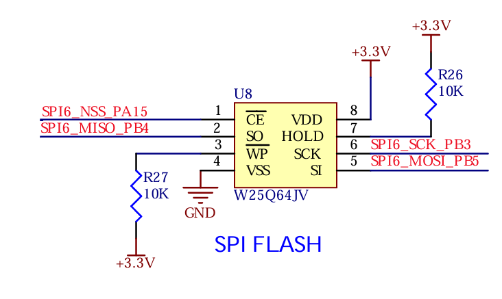

These are my connections:

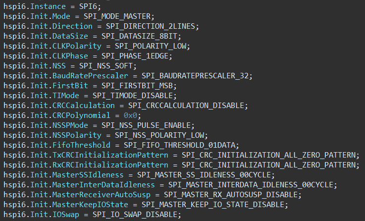

And these are my SPI and RCC and GPIO settings:

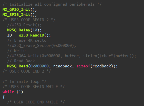

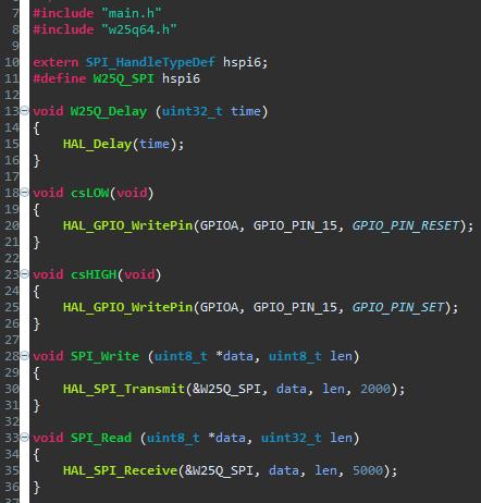

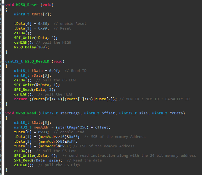

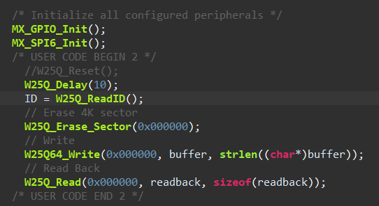

And these are my functions and main code:
Using W25Q_ReadID function, i could read device ID.
But i can't read data stored on device using W25Q_Read.

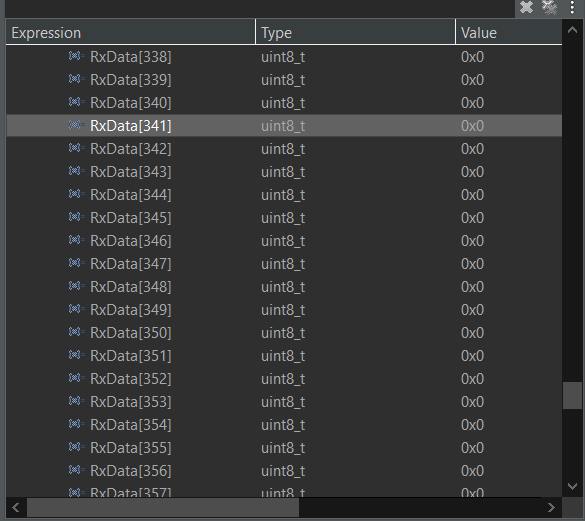

these are my result that i think they're wrong:
what's wrong with my code or configurations?

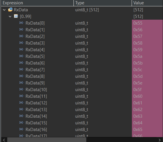

Why? You haven't written anything, so what are you expecting to read out?
A proper test would be to erase a block, verify it reads back 0xFF, then write to it, and verify it read out the same as you wrote.
You only reading 20 bytes, so it's irrelevant what RxData[341] is.
85 in hex is 0x55. Probably that's what you wrote there and the code is working fine.

TDK
Super User

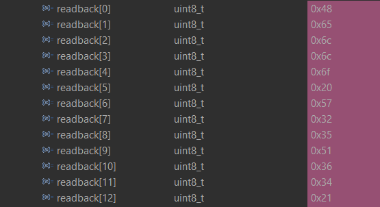

Dear @TDK thanks for your helpful suggestion. that was true and it works.

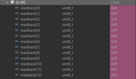

Dear @TDK i have another problem. when i erase and write the chip and after that i read the chip, i read my written data.
But after that, when i just read the chip it shows 0xff
why?
