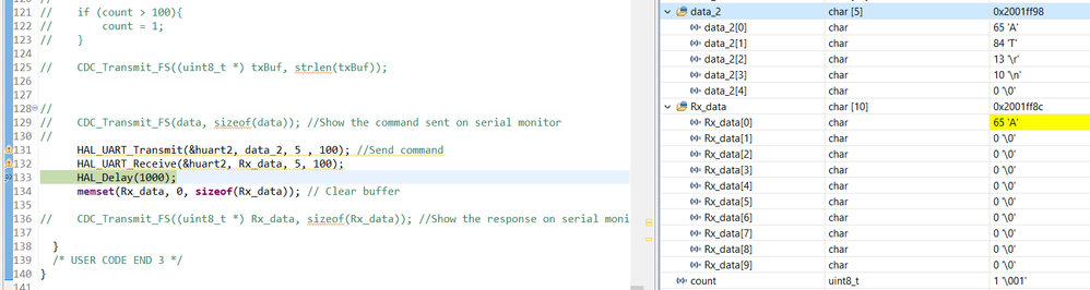

2021-09-15 7:03 AM
Im trying to get a response, this is the best i get back:

2021-09-15 8:45 AM
I figured out that the response of the ESP is much longer than just "OK\r\n".
The response is made up of two parts, 1) the line I just send , 2) the actually response.
So the response is "AT\r\r\nOK\r\n".
I had to use a bigger char array to store all the data.
