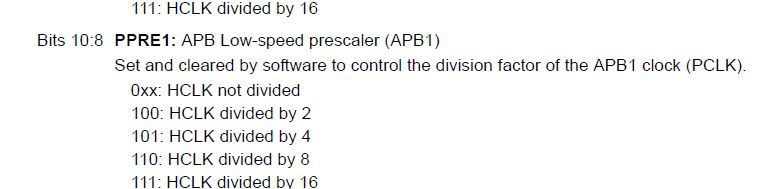

Hi all,
I've some problem with APB1, APB low speed prescaler setting. File stm32f30x.h of STM32F3-Discovery_FW_V1.1.0\Libraries, reports the below PPRE1 meaningin according with DM00043574 pg. 142:#define RCC_CFGR_PPRE1_DIV1 ((uint32_t)0x00000000) /*!< HCLK not divided */
#define RCC_CFGR_PPRE1_DIV2 ((uint32_t)0x00000400) /*!< HCLK divided by 2 */
#define RCC_CFGR_PPRE1_DIV4 ((uint32_t)0x00000500) /*!< HCLK divided by 4 */
#define RCC_CFGR_PPRE1_DIV8 ((uint32_t)0x00000600) /*!< HCLK divided by 8 */
#define RCC_CFGR_PPRE1_DIV16 ((uint32_t)0x00000700) /*!< HCLK divided by 16 */
I've tried to set all the PPRE1 values in SetSysClock() and measured with my scope, and I see that:
RCC_CFGR_PPRE1_DIV1 HCLK not divided
RCC_CFGR_PPRE1_DIV2 HCLK not divided
RCC_CFGR_PPRE1_DIV4 HCLK divided by 2
RCC_CFGR_PPRE1_DIV8 HCLK divided by 4
RCC_CFGR_PPRE1_DIV16 HCLK divided by 8
Have you aver seen the same behavior?

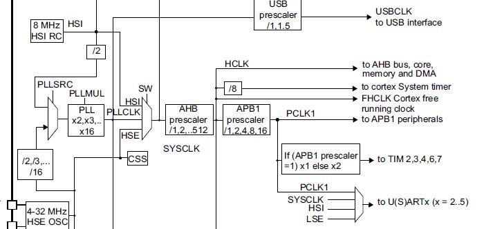

Look to RM on picture with RCC structure.
If APB presc > 1 then TIM clk is multiply by 2.2016-01-12 2:32 AM
Here below the picture from DM00058181 pg 18:
as you said ''if (APB1 presc. = 1) x1 else x2. but this is in contrast with what I see:APB1 presc = 1 or APB1 presc = 2 , TIM3_CLK is the same!if APB1 presc = 4, TIM3_CLK double2016-01-12 2:49 AM
Consider AHB clk = 16Mhz
APB2_div = 1 -> TIM CLK = 16MHz APB2_div = 2 -> TIM CLK = 16MHz APB2_div = 4 -> TIM CLK = 8MHz APB2_div = 8 -> TIM CLK = 4MHz.2016-01-12 4:21 AM
Thanks dembek, now it's clear!
Consider AHB clk = 16MhzAPB1_div = 1 -> TIM CLK = (AHB/1)x1 = 16MHzAPB1_div = 2 -> TIM CLK = (AHB/2)x2 = 16MHzAPB1_div = 4 -> TIM CLK = (AHB/4)x2 = 8MHzAPB1_div = 8 -> TIM CLK = (AHB/8)x2 = 4MHz.We’re moving the ST Community to a new platform to give you a better and more reliable community experience.
