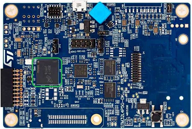

Clocking at 52 MHz 8-bit DDR mode, should be able to get a lot closer to 104 MBps, trying to decide if it is the card or the bus/peripheral getting in the way.
Also not impressed by the write speed either, but more frustrated with the bottleneck on the read, specs suggest it should go a lot faster.

Dialled a lot of knobs on the clocking side (sources, ratios, cpu, sdmmc, etc), learned a few things that aren't well documented and not reflected in the library/bsp source.
Suspect it is pacing controlled by the Micron part, but not sure what settings/sequences unlock the speed.
DDR should double the throughput, even doubling CLKCR doesn't improve things.
The part seems to be self clocking or aware, as the input clock changing doesn't move the needle the way it might be expected.

>>There's a beefy controller inside, would you expect it to be otherwise?
Probably a lot of state machine / data path logic stuff bolted to an 8051/251 on steroids.. I guess I could hope its an ARM, MIPS, or SPARC, but not holding my breath.
JY976
MTFC4GACAJCN-1M WT
The spec of 14 / 90 MBps for the DDR52 Write/Read are about 3x what the STM32L+ is pulling out of it.
Missing the exact JEDEC JESD84-B50 incantations for the magic to happen
Mouser says the part is EOL, so buring some stock here. Would have preferred a SanDisk part.
