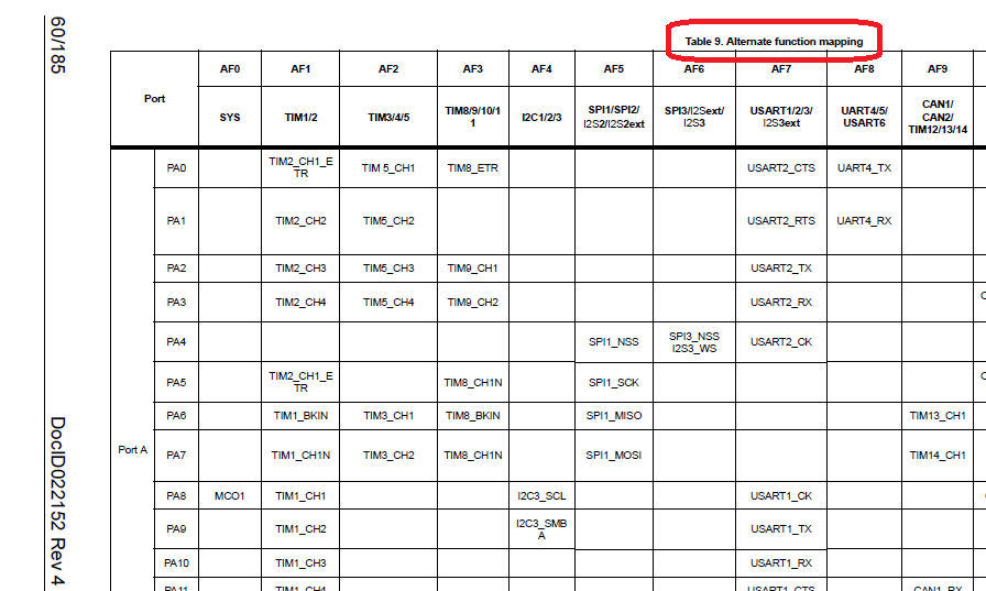

at page 135 of , I found a note: ''To know which functions are multiplexed on each GPIO pin, refer to the datasheets.'' But I didn't find the datasheet forSTM32F303VCT6.
At the end, I need to know which value insert in the registers GPIOx_AFRL and GPIOx_AFRH. Can someone help me?Thanks #lmgtfy #lmgtfy:-stm32-resources #alternate-function-mapping #stm32f303vct6-alternate-function #goes-to-152013-12-11 6:33 AM
Look into STM32F4xx datasheet, http://www.st.com/st-web-ui/static/active/en/resource/technical/document/datasheet/DM00037051.pdf , page 60 and on.
JW2013-12-11 7:09 AM
the datasheet you have mentioned above has specified the alternate function correctly but not in my case of stm32f407vg controller inUM1472User Manual....its like AF ..
Sometimes I wonder if people here are ********... Yes because they are different bloody parts, try Googling YOUR parthttp://www.st.com/web/catalog/mmc/FM141/SC1169/SS1577/LN11/PF252140
andhttp://www.st.com/st-web-ui/static/active/en/resource/technical/document/datasheet/DM00037pdf

There are more peripherals with inputs and outputs than there are pins on the device. The ability to multiplex (mux) them to different pins provides some degree of flexibility in the peripherals and devices used. Routing every function to every pin would require a ridiculous amount of silicon, so the the choices are limited, you might have to juggle things to get the set of functionality you want. It's not possible to use all peripherals at once, it's a general purpose device, and most people only need a subset for their designs.When using external memory buses, and LCD, these soak up a lot of pins, and often require much higher pin count devices.2015-11-19 6:29 AM
