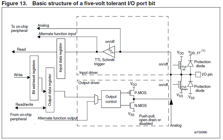

I'm familiar with using alternate function inputs on the STM32F1 series; the associated GPIO pin is set as an input (CNFx[1:0], MODEx[1:0] bits), AFIO clock is enabled, and the AFIO->MAPR register is set appropriately.
I'm confused how to do the same on STM32F4. Reading the reference manual (RM0009), table 14 seems to indicate alternate function is always output, either OD or PP, with/without PU/PD. In the timer input capture example distributed with the STM32F4 peripheral library, the input pin is put into output PP mode.I find this a bit confusing -- can anybody clarify the use of alternate function inputs on the STM32F4xx series?2012-09-22 3:39 AM

The AF muxing fabric (ie peripheral pin routing) has control of the output state, and output enable (ie H, L, Z), and can read the current state. It thus controls the input/output.
You can configure if one or two of the transistors drive the output state (ie OD or PP), and UP/DOWN/NONE state of the pull resistors. For interfaces like I2C you're going to want OD output, where as SPI and USART you're going to want PP output. For a pin you know is going to be an input, which you choose is immaterial, it'll just take less initialization code to assign 2-4 pins for an interface simultaneously, which is what the library does.2012-09-24 1:40 AM

Not *completely*. It only controls, whether the pin is input or output (more precisely, whether the output transistors are on or off). > In other words will selecting AF OD, AF OD + PU, AF OD + PD, AF PP, AF PP + PU, AF PP + PD all have no effect? Only if the connected peripheral uses the pin as input, the PP/OD setting is ignored, as the output driver is completely off. (As far as I understand, PU/PD settings are always ''obeyed''). This is the same as with setting pin in GPIO mode as input (so if the pin is input you can write what you want into the GPIOx_OTYPER register, and PP is its default state anyway). JW2012-09-24 5:21 AM

I originally had corresponding GPIOs configured with MODER[1:0]='00' (Input mode) and the appropriate AFX bits set in the corresponding AFRL/AFRH to connect the timer peripheral to the correct GPIO pins. This does not work. I had to select MODER[1:0]='10' for it to work.So, the moral of the story is that if you need to use an alternate function of a GPIO, you must set MODER[1:0]='10'. The connected peripheral will then select whether the input or output driver is used. If the connected peripheral selects the input driver, then the OTYPE bit and the OSPEED bits of the GPIO pin is effectively ignored. If the connected peripheral selects the output driver, then the OTYPE bit and the OSPEED bits are used. In both cases, the PUPDR[1:0] bits are still applied.Hopefully this helps others if they have similar confusions about Table 14.We’re moving the ST Community to a new platform to give you a better and more reliable community experience.
