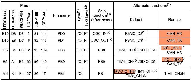

ONLY PINS CONFIGURATION
GPIO_InitStructure.GPIO_Speed = GPIO_Speed_50MHz;
/*--------------------------------------------------------------------------------- PD.0 / PD.1-------- */ GPIO_PinRemapConfig(GPIO_Remap1_CAN,ENABLE); // THAT OR THE FOLLOWING? GPIO_PinRemapConfig(GPIO_Remap2_CAN,ENABLE); /* --- Configure CAN pin: RX ---------------- */GPIO_InitStructure.GPIO_Pin = GPIO_Pin_0; GPIO_InitStructure.GPIO_Mode = GPIO_Mode_IPU; GPIO_Init(GPIOD, &GPIO_InitStructure); /* --- Configure CAN pin: TX ---------------- */ GPIO_InitStructure.GPIO_Pin = GPIO_Pin_1; GPIO_InitStructure.GPIO_Mode = GPIO_Mode_AF_PP; GPIO_Init(GPIOD, &GPIO_InitStructure);
/*--------------------------------------------------------------------------------- PB.0 / PB.09 -------- */ GPIO_PinRemapConfig(GPIO_Remap_I2C1,ENABLE); GPIO_InitStructure.GPIO_Pin = GPIO_Pin_8 | GPIO_Pin_9; GPIO_InitStructure.GPIO_Speed = GPIO_Speed_50MHz; GPIO_InitStructure.GPIO_Mode = GPIO_Mode_AF_OD; GPIO_Init(GPIOB, &GPIO_InitStructure); /*----------------------------------------------------------------------------------------------- PB.01 ----- */ GPIO_InitStructure.GPIO_Pin = GPIO_Pin_1; /* PB.01 ADC CHANNEL 9 */ GPIO_InitStructure.GPIO_Mode = GPIO_Mode_AIN; /* ANALOG INPUT */ GPIO_Init(GPIOC, &GPIO_InitStructure); /*--------------------------------------------------------------------------------------------------------------- */ FOLLOW THE NEXT FIGURE

If you want to use a port pin for alternate function, you
always
have to configure it: * For peripherial outputs (like Usart TX, SPI CLK) normally AF_PP or AF_OD must be used. This disconnects the pin driver from the GPIO and connects it to the peripherial * For inputs (e.g. RX, SPI MISO) normally IN_FLOATING, sometimes IPU/IPD is required. (BTW: This means that reading the state of the GPIO pin is still possible) Chapter 8.1.11 in the Useguide shows the configuration for every peripherial. (you will find I2C listed with AF_OD there) With remapping, you simply route the peripherial lines to another port. Sometimes you have more than one choice. CAN is initially found on PA11/12 and might go to PB8/9 or PD0/1 when remapped. This is the reason why GPIO_Remap1_CAN (for PB8/9) and GPIO_Remap2_CAN (for PD0/1) exist. And to make things even more complicated, some peripherials can be partially remapped...2011-05-17 5:11 AM
