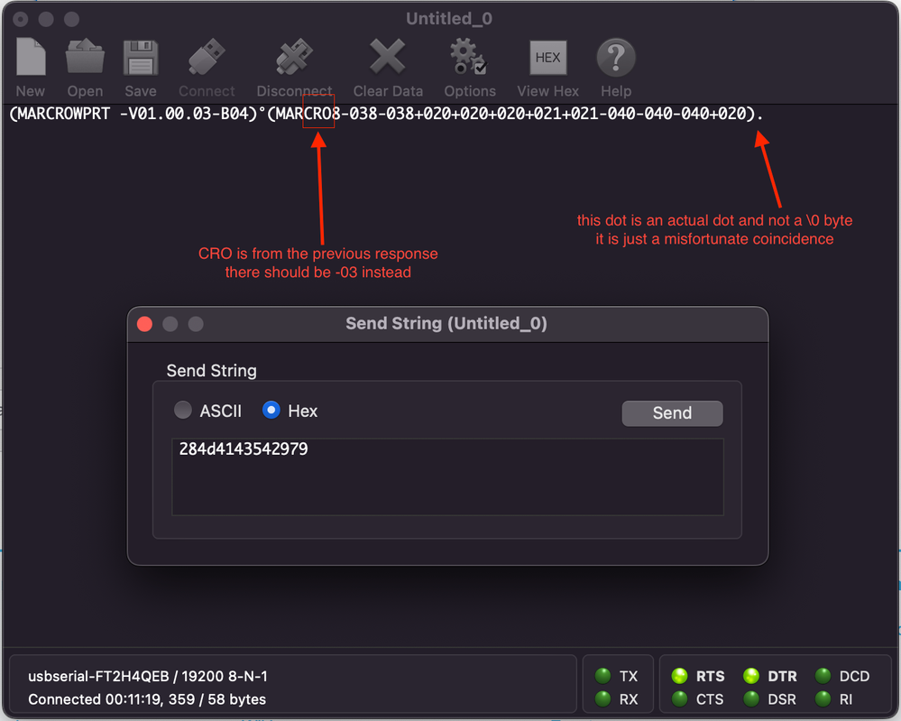

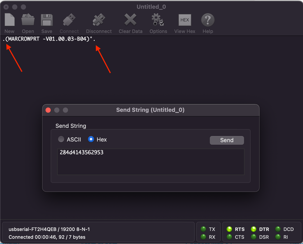

}When I send a command from the terminal I get the response back. But there are \0 bytes represented by '.' in the terminal.
That's not intended to be there. See the picture below:

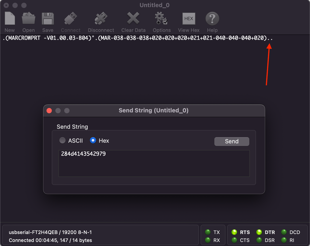

When I send a second command it looks also right but the \0 bytes still there:

The dot is not appearing but the commands response is not working find as you can see from the picture:

If I try with another command is even more evident. Is like the first 6/7 bytes are still coming from the previous command response.
