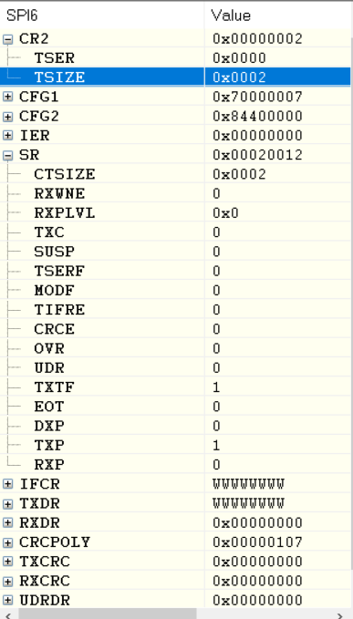

I am trying to make SPI6 work with BDMA I see that transfer completion flag set in BMA ISR but SPI registers i don't see EOT bit set. I don't see any data coming from MOSI line of SPI6. Please help me know what is going wrong. There is no error set in any of the registers I have attached a screen shot of BDMA and SPI6 registers. I am using BDMA channel 0 for Rx and BDMA channel 1 for Tx.

I tried in polling method after i use HAL_SPI_Transmit its waiting in
while ((__HAL_SPI_GET_FLAG(hspi, Flag) ? SET : RESET) == Status)
for EOT flag in SR register to be set. What can be the reason for this?
I see the SPI6 registers are getting filled properly.
