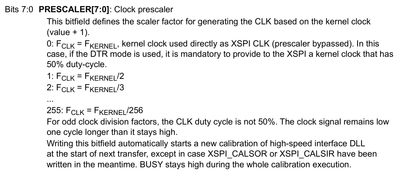

I'd modify the PRESCALER field in XSPI->DCR2 directly. Set the prescaler so that 100 MHz is generated during initialization then cut it in half after switching to high speed mode.

2025-02-13 6:19 AM
Just setting the field should work.
Haven't used the XSPI on the H5, but that's how similar peripherals work on other chips. Perhaps change in this manner from 1 MHz to 2 MHz and verify on a scope or logic analyzer that everything is copasetic.
