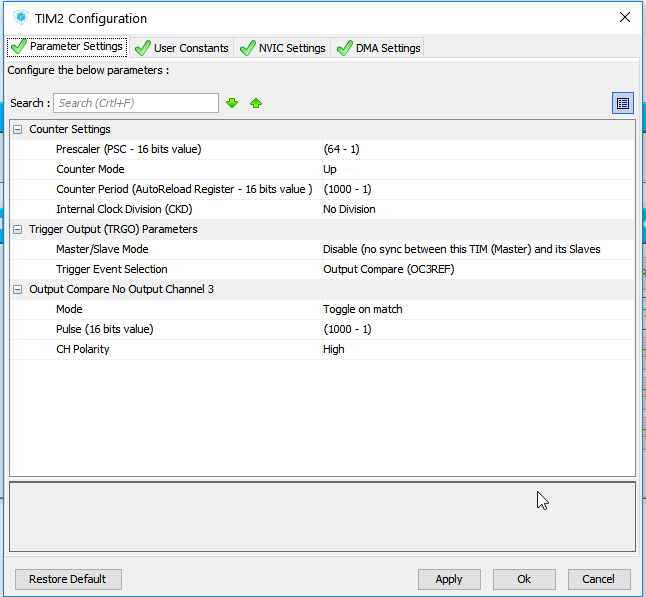

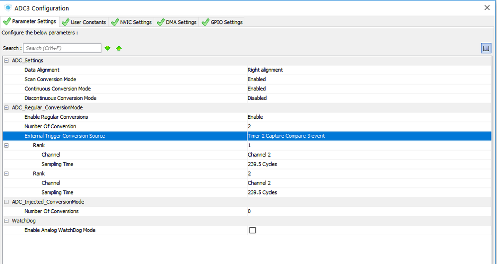

I'm using a STM32F103 MCU and I want to sample two signals with ADC3.
I also want to sample the signals at 1kHz and to do that I think to use:
With Cube32Mx, I configure the ADC3 to be triggered by TImer2 Caputre Compare 3 event.
My problem is: I don't know ho to configure the timer to generate the trigger for ADC3.
These are my settings for ADC3
These are my settings for Timer2:
Thanks for the help!

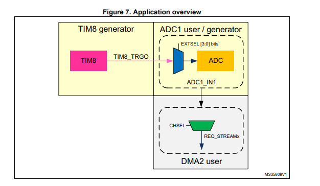

Hi
Rini.Federico
,In the
application note you may find an example with snnipet of code about how to set up ADC1 to start single conversions every time TIM 8 overflows. Each time an end of conversion occurs the DMA transfers the converted data from the ADC to memory:-Nesrine-

,I give you this application note as reference to develop your own application.
otherwise refer to this example under the STM32F1 cube package :
STM32Cube_FW_F1_V1.6.1\Projects\STM32VL-Discovery\Examples\ADC\ADC_Regular_injected_groups
-Nesrine-

I understand how to trigger the adc conversion by timer but I don't understand how to configure the peripheral with CubeMx and if my settings (show on top) are correct.
