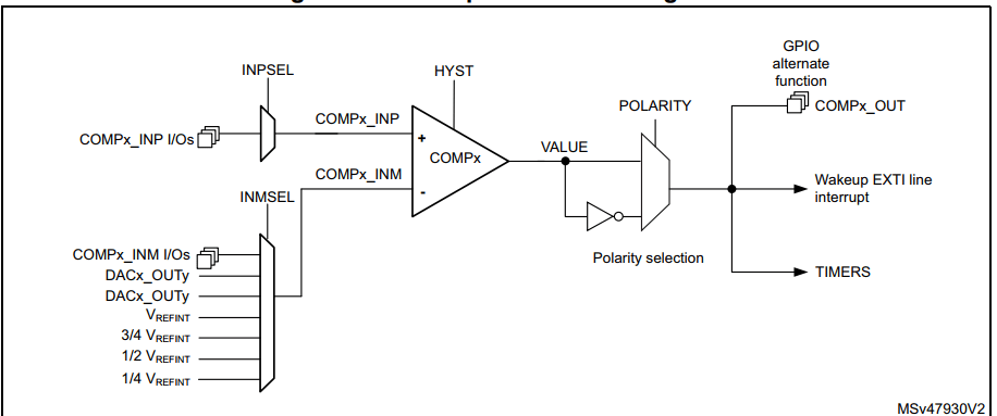

As far as I know, comparators are used for this.
The Analog Comparator is used to compare the voltage of two analog inputs, with a digital output
indicating which input voltage is higher. Inputs can either be one of the selectable internal references or
from external pins.
See here: https://kalapiinfotech.in/stm32-peripherals-comparator/
