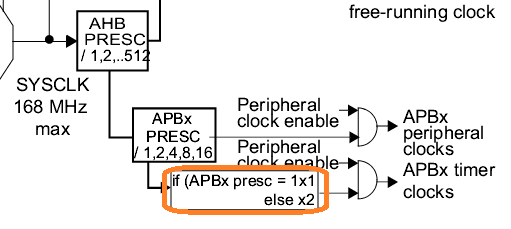

I'm currently working on a brushless motor control application and i'm in the process of implementing the current measuring of the three phases. In order to do so, I need to synchronise the ADC sampling with the PWM outputs in order to sample at the center of the PWM outputs (center aligned 2 mode).Unfortunately cannot find a simple solution. From the datasheet i see that the ADC can be trigger by either the CC1-4 timer interrupts or the TRGO interrupt. However, from what i've read, the interrupt that that the ADC needs to trigger off of is the timer update interrupt (which is not in the list of available ADC triggers external triggers).Am i understanding this correctly? I was expecting a straightforward solution as this is a common problem in any motor control application, which is one of the mains features of the advanced timers.Thanks,Alex #stm3-adc-trigger2013-08-27 6:33 AM
You appear to be making things more complicated than they are. No, you're not limited to the Update, but you have specific timers and channels that are usable. In fact to use the Update you'd have to select that as a TRGO output, then select that as a trigger input to the ADC. You don't specify a part, so for the F4 we have the following options:/** @defgroup ADC_extrenal_trigger_sources_for_regular_channels_conversion

2013-08-27 6:42 AM
// STM32 ADC Sample @ 200 KHz (PC.1) STM32F4 Discovery - sourcer32@gmail.com
// Assumptions per system_stm32f4xx.c CPU @ 168 MHz, APB2 @ 84 MHz (/2), APB1 @ 42 MHz (/4)

TIM_TimeBaseStructure.TIM_Period = (84000000 / 200000) - 1; // 200 KHz, from 84 MHz TIM2CLK (ie APB1 = HCLK/4, TIM2CLK = HCLK/2)

2014-09-24 2:34 AM
it tested your code on my discovery board and it doesn't work for me. The led toggles with a frequency of 100Hz. My clocks are correctly configured: SystemCoreClock = 168MHz, APB1=42MHz, APB2=84MHz.Can you provide your SystmInit code. I also noticed, that you assumed, that TIM2 runs at SystemCoreClock / 2 = 84MHz. Why? Tim2 is on the APB1 so it must run at 42MHz??2014-09-24 3:08 AM
OK I fix it. The problem was that the my systemInit was not called.
On the other hand, it is still interesting for me, why TIM2 runs on 84MHz and not on 42MHz?2014-09-24 5:17 AM
TIMCLK is APBCLK*2 in all cases except DIV1, review the Reference Manual, Clock Tree
