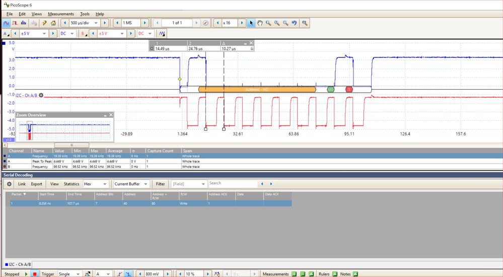

I've got an issue that the STM32L432 on the Nucleo running a simple I2C I/F isn't working with a DHUT21 when exactly the same code on the 433 is fine. The same I2C code on both chips works fine with a BMP180 and many other devices. This is reproducible across some but not all Nucleo-L432 boards - some work OK with the DHUT21. The signals look fine except that the sensor is NAKing the address on the 432. Any ideas appreciated.

The 'L432 and 'L433 I2C should be identical, so the difference lies in the external circuitry.

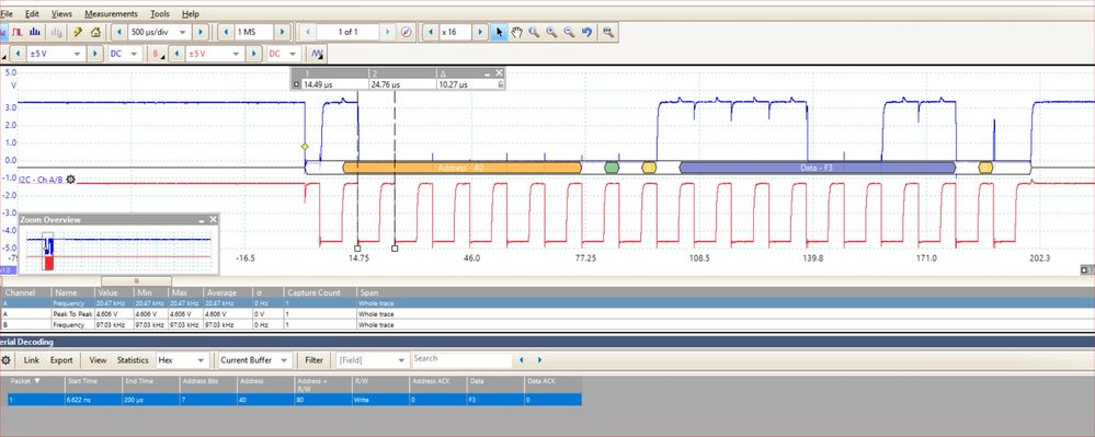

From the waveforms you've posted, SDA changes a tad bit too soon after SCL falling edge to my liking. Try to increase I2C_TIMINGR.SDADEL .

Thanks for the suggestion. Adding delay makes it work BUT only when the scope is connected to SCL!
It looks like there is something funny about STM32L432KC (32-pin) and also the DHTU21 (a poor I2C implementation?) and together....
I can replicate the problem both on the Nucleo and on a breadboarded STM32L432KC
Interesting on the new scope trace is that while I2C_TIMINGR.SDADEL affects the change of SDA after clocks 0-6 it does not change the timing of clock 7 when SDA is released immediately on the downgoing edge of the ACK/NAK clock pulse
UPDATE fixed by adding 56pF between SDA and GND - I think the issue is the very fast release of SDA after the last clock
