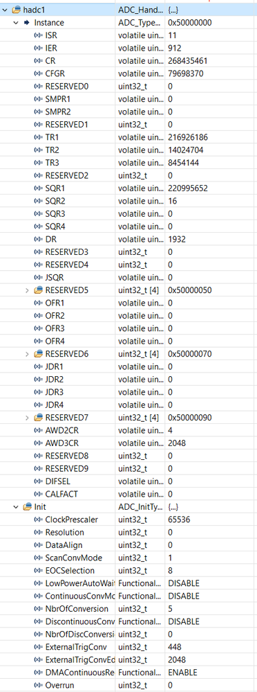

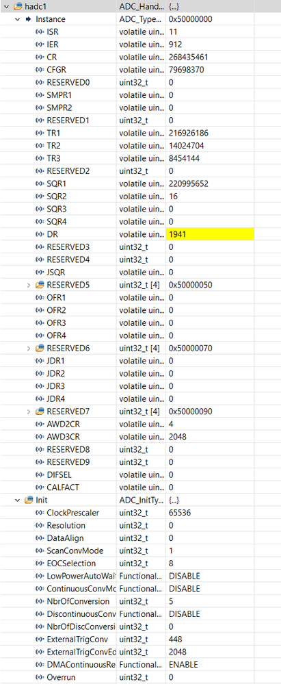

In addition, find attached the a picture with the ADC object before and after crashing.

Are you checking the ADC->DR register to determine if the reading is wrong or are you checking the value stored in memory? Your screenshots show the same DR value in both of them, within tolerance.

I'm using the ADCs in Dual regular simulataneous mode and collecting the values with the DMA. Then on ADC EOC interrupt, I'm parsing the values from the DMA and storing them in memory. The values I'm checking are in memory.
ADCs DR do not match the values before nor after crashing. I think that using the ADC in Scan mode, the DR register should keep the value of the last conversion. But that is not happening. :\
It's of little help, but changing the optimization -O1, -O2 makes the issue disappear. However after further code changes it appears again.

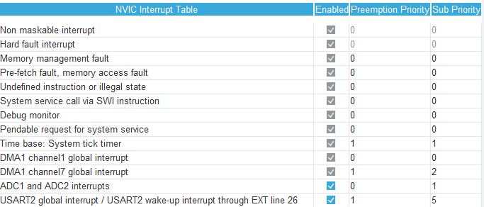

I'm sampling at 20kHz with timer trigger. My device is the stm32f334r8 and I don't think I have the fifo feature in the DMA so i will say no. I understand that the overrun is caused by the DMA not being able to service the ADC.
Then the only reason I can think of is that an interrupt with higher priority than the DMA is running and not allowing the DMA requeest to be serviced. Looking at my NVIC (and assuming that the DMA request will have the same priority as the DMA Interrupt, which is some assumption) configuration I dont really know what can the conflicting interrupt be,
In the interrupt for ADC EOC, I set a digital output to '1' on entering the INT and back to '0' at the INT end and analysed the digital output witha logic analyser and the CPU usage time is within threhold (11us) and I can also see that the digital output is at 0 when the error happens (I have a watchpoint at the error variable). What other reasons could there be for the overrun?
