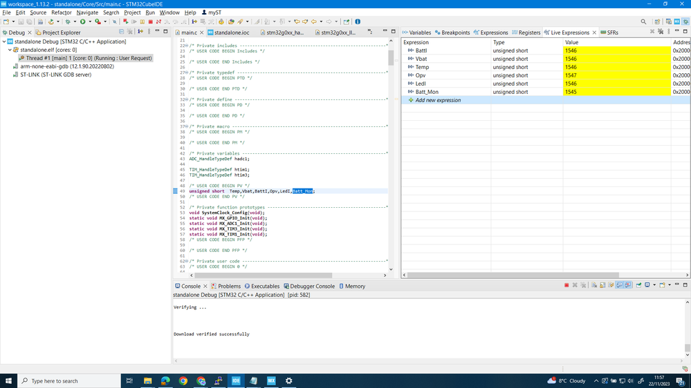

Is any otherways to read adc values for sequencer not fully configured mode as using channel 16 and channel 15.
I have tried it witout DMA but seems to getting all values same I am stuck at a project to proceed as we need adc values to proceed

2023-11-22 4:05 AM
Thanks for your kind response and help here i have attached the entire code and what values i am getting debugger .If you can please check.this I have done by polling
unsigned short Temp,Vbat,BattI,Opv,LedI,Batt_Mon;

2023-11-22 7:23 AM
Your MX_ADC1_Init is set up to initialize the ADC for 6 conversions, but then you're trying to do single conversions. Might be other issues as well.
Perhaps go off of a working example code from the MX repository.
Here's an example for multiple conversions using DMA:
There are quite a few others available in the Example Selector within CubeMX for the G0 series.
2023-11-27 6:44 AM
these examples i tried as a result reading same values for all channels
