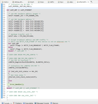

Through your heIp I managed to get to the point where Error_Handler() is called. Here:
But I can't explain one thing, the point in question is this, but that whole block of code is grayed out, as if none of the LWIP_ARP or LWIP_ETHERNET macros were defined
How should I interpret this situation, should that code not be executed?
Did I do something wrong in the configurator?
2023-11-27 6:45 AM
Sometimes the IDE parses things wrong. Look for the LWIP_ARP or LWIP_ETHERNET defines and ensure they're defined somewhere prior to the posted code.
