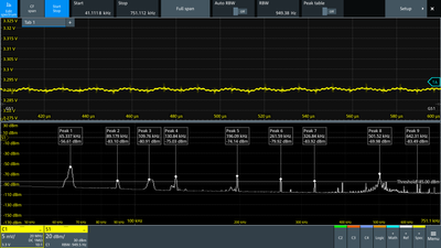

Thanks @ONadr.1 and @TDK for reaching out. At the moment there is no output filter used on the op-amp, only a lagging capacitor placed between non-inverting and inverting inputs of op-amp. The impedance of this signal is very low considering its the output of the op-amp. The digital signals are away from analog circuitry. I have just investigated to see what my VDD/VREF+ are experiencing and this is what I found:
There is a 65.3 kHz ripple which comes from the switching frequency of the converter and its harmonics. However, there is a noticeable superimposed, relatively high amplitude noise at 500 kHz which is due to an external bias supply (flyback) switching.
I might have to filter this out more, provided that the ripple is easily higher than 1 LSB (800 µV) of ADC. I am even considering of using a PI filter from VDD to VREF+, what are your thoughts on that? I could try filtering out at least higher frequencies with this method?
Note: the signal spectrum is captured with 'hold max' method and limited to 20 MHz.
