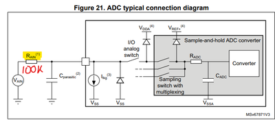

I want to use the ADC on a low frequency signal (around 1kHz). My application needs to be very low power so I decided to put a big (around 100kOhms) input resistance on the ADC pin like we can see in the picture below.

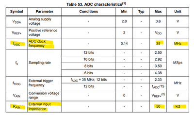

The problem is that in the datasheet the maximum value of the resistance is 50kOhms.
I want to make sure that this maximum value is given only for one ADC clock frequency (35MHz in my case) and that if we lower the ADC frequency we can increase the Rain value. Am I right ? So if I use a 8MHz ADC clock, I can put a 100kOhms input resistance.

The ADC input has no DC input current/resistance, so why you put a big resistor at the input ?
when we increase Rain, we lower the input current in the ADC but we increase the voltage drop across Rain so we increase the error. Is it true ?
Yes. The ADC input is capacitive and switches some 5pF or so to the input pin, every time you start a conversion.

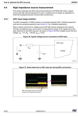

Dear @Pierre75 ,
You can refer Our Application Note here
on how to optimize conversion in this case of high impedance Source .
Hope it helps you
Cheers,
STOne-32
