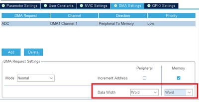

Hello @Pejwaak ,
Change Data width of Peripheral and Memory to "Word" instead of "Half Word":
Please confirm if this solves your issue.

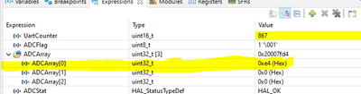

I have already tried it but tried it again any. I am attaching this screen-shot so you know exactly what I mean. Every-time ADC complete flag was set I took a screen shot. as you can see the value of the first element of ADCArray changes. I tested them and it turned out that these differents values are the values from each three channel.ADC3.PNGADC1.PNGADC0.PNG
