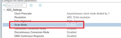

I attached a project where I did 3 channels conversion in continuous mode with DMA on STM32L152D_EVAL board. Unfortunately, I don't have your board on hands.
The three converted channels are:
- Channel 31: potentiometer
- Channel 16: temperature sensor
- Channel 17: Vrefint
I tested the project with IAR, you can port it easily to CubeIDE with CubeMx.
As you can see in this screenshot, the data converted are arranged in the correct order.
You can inspire from my project to find your issue.

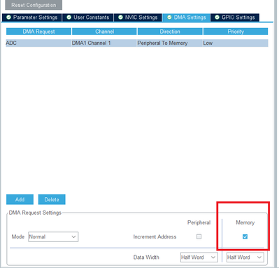

Hello @Pejwaak,
Please, make sure in your DMA settings you have correctly enable the incrementing address of "Destination Address".
Feel free to share your settings :)

Did you enable Scan mode?
Did you enable Memory incrementation in DMA config as stated by @GwenoleB ?
