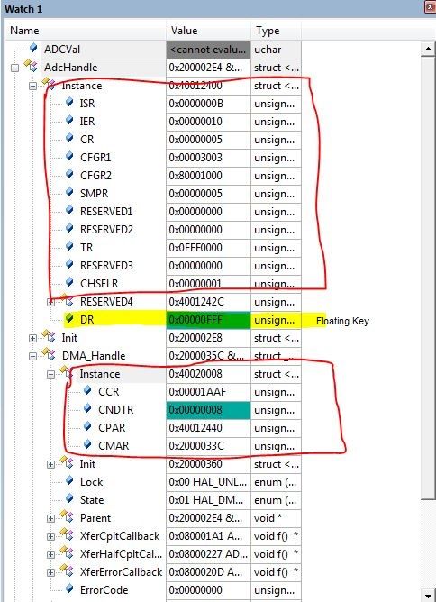

Edit : I checked ADC and DMA register by KEIL debugger, here the screenshoot
This is condition when I comment MP3 (i2c) code, Register value seem OK.
register DR value is FFF when no key press. And when I press each key, it give desired value.

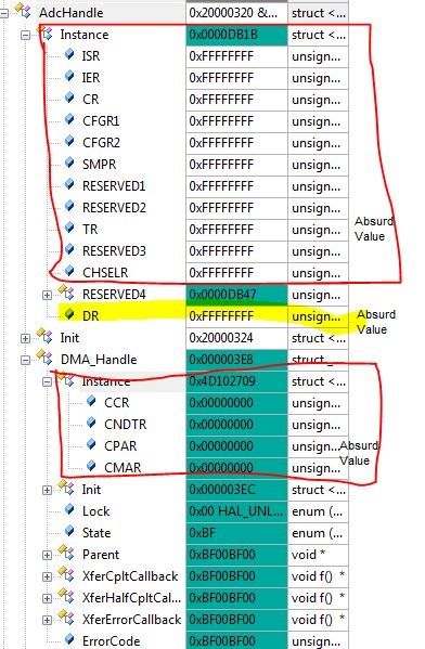

And here normal condtion (MP3 I2C active).
Both ADC and DMA register value are absurd. Sometime it change to random value.
But MP3 function is works. Its like there is collision between I2C and ADC. ADC peripheral address suddenly change every time read and write data via I2C.

Because this error very strange. I change I2C buffer size then suddenly when I place breakpoint at :
HAL_I2C_Master_Transmit(&I2CHandle,(uint16_t)LSI_ADDR_WR,(uint8_t *)temp, len_1 + len_2,1000)
also I place breakpoint inside HAL_I2C_Master_Transmit function then click run it didn't stop at second breakpoint. It go to HardFault_Handler().
HAL_driver sometime give me odd error.
