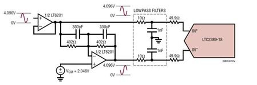

if you show the complete input circuit to the adc, it could be possible to help....
2023-05-29 12:39 AM - edited 2023-11-20 4:28 AM
2023-05-29 1:30 AM
ok, ...from LT data; you build exactly so?
