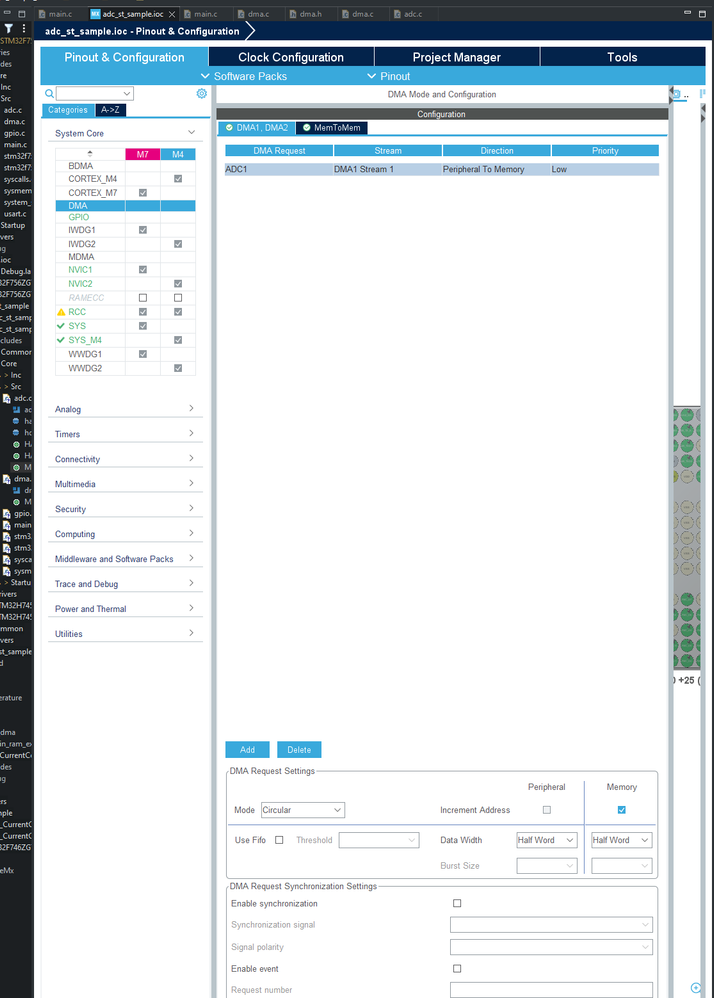

2023-04-20 5:54 AM - edited 2023-11-20 7:43 AM
Some example:
2023-04-20 6:17 AM

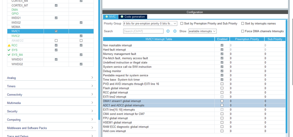

2023-04-21 12:12 AM - edited 2023-11-20 7:43 AM
Ok, so achieved your target with DMA. Interrupts You can still disable in the nvic label if you want:

2023-04-21 12:57 AM
Thank you sir for your Help .Now You got the my point After disabling the NVIC for DMA i didn't get Any Data's Why ? (if you are achived this Can you share the Code/Zip file it would be very helpfull) . whenever DMA NVIC present that time i got the Data no issues working Fine.

2023-04-21 4:05 AM
You will learn a lot when reading the reference manual and the registers, then looking into the HAL functions to see what's going on.
So you might check what's going on in:
HAL_ADC_Start_DMA() shows you that DMA interrupts are enabled.
And the callback functions ADC_DMAHalfConvCplt() and ADC_DMAConvCplt() are set for DMA interrupt callbacks. Which do some housekeeping and then call the HAL ADC callbacks... (which shows us that this might not be the fastest solution...)
HAL_DMA_IRQHandler() which is called at each DMA interrupt.
It's mostly error handling, but also resetting (half-) transfer complete flags, and calling the (half-) transfer complete callback functions.
So all that might give you the hint that you need the DMA interrupts for that ADC DMA stream.
What you do in the HAL ADC callbacks is your thing.
Maybe set a flag to show that new data is available?
Anyway, when using ADC with DMA you do NOT need that ADC_get_value_whatever function, DMA is writing the ADC values directly into the specified buffer at DMA start.
Stop relying on CubeMX and HAL stuff alone. Start learning and thinking!
