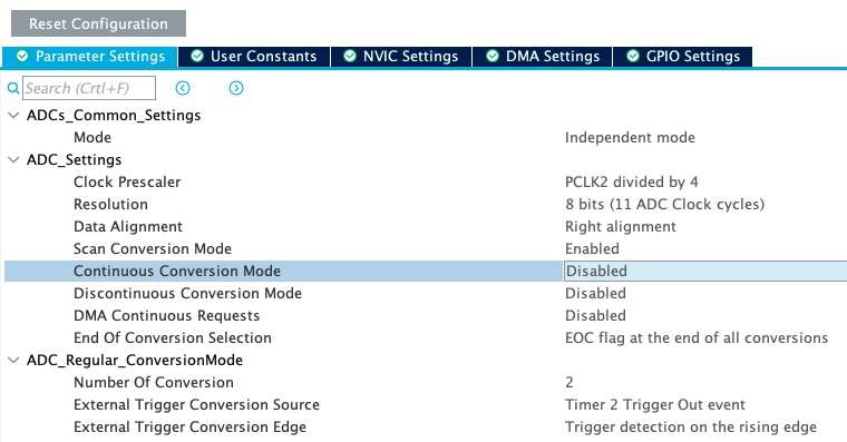

2020-12-25 10:15 AM
"You can either convert ALL channels per trigger, or one per trigger. It is configurable." - How? The ADC settings are as shown below,
2020-12-25 8:17 PM
> How can I do this? I thought I was doing this in the ADC configuration when I set it to start conversion with the Update event of Timer 2.
You've connected the conversion start to the Timer 2 TRGO event, not necessarily the update event. You need to select update as the TRGO event selection within the TIM2 settings.
To convert one channel per trigger, enable discontinuous conversion mode and select 1 discontinuous conversion.
If you're trying to use circular DMA with the ADC, you need to enable DMA continuous requests.
Once all that is set up, I would process the results using the DMA half-complete and complete callbacks (HAL_ADC_ConvHalfCpltCallback/HAL_ADC_ConvCpltCallback).
2020-12-25 10:58 PM
Oh yes, I have set the TIM2 to update event in its settings, and then selected Timer 2 Update Event under the ADC trigger settings. I thought you were referring some other way to do it.
Got it. I have 7 channels that I need to process in one go. I can setup discontinuous mode to processes all 7 in one event trigger.
You mean do something with the ADC data buffer here since the HAL_ADC_Start_DMA anyway transferred the data to the defined buffer?

2020-12-26 7:14 AM
If you want to convert all channels on each trigger, just leave this mode disabled as that is the default behavior.
Yes. You could also do whatever you wanted with the data in HAL_ADC_ConvCpltCallback instead.
