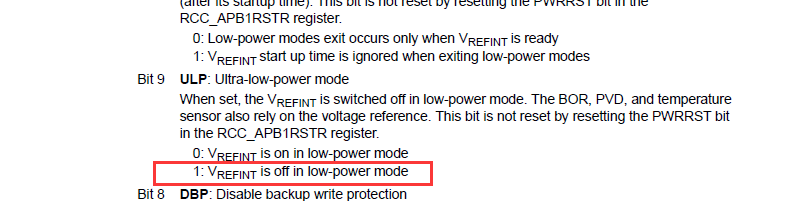

thanks all of person's help, finially, I found the fix. if I enable ultra low power mode, this issue disappeared, although I don't understand the real reason.
HAL_PWREx_EnableUltraLowPower();

Has anyone found a solution? In any configuration if we enable ULP, after STOP wakeup the vref seems corrupt.
2023-10-30 10:04 AM
Try disabling the ULP before ADC calibration and enable when you are done with the ADC.
This worked for us:
void ADC_Start() {
LL_PWR_DisableUltraLowPower();
HAL_ADCEx_EnableVREFINT(); //Wait for vref to start
HAL_ADCEx_Calibration_Start(&hadc, ADC_SINGLE_ENDED);
HAL_ADC_Start_DMA(&hadc, (uint32_t*) &ADC_raw, adc_Channels);
void HAL_ADC_ConvCpltCallback(ADC_HandleTypeDef *hadc) {
HAL_ADC_Stop_DMA(hadc);
LL_PWR_EnableUltraLowPower();

@Head
After several hours I have found what was wrong.
When I switch to Ultra Low Power Mode I had to switch IO ports to alternative function mode too ( to save some current ).
And that was the reason.
On PB0 or PB1 ( don't remember ) I have Vref out with few uA ability to drive with pull down on same pin.
So when I swich port to alternate function I have pull down on Vref and it is not able to restart properly due to load.
It is enough to not switch I/o port to AF before entering ULP. Instead AF , input is enough.
