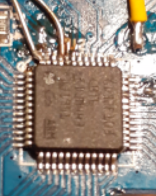

Dear @bobcov ,
Can you share a picture of the top marking on the device.

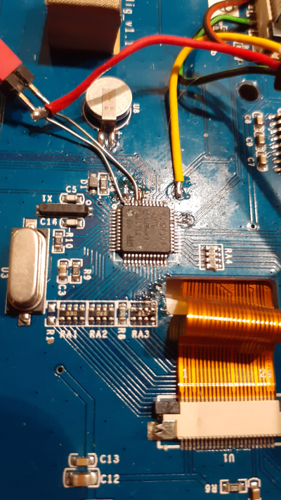

Hi, hard to get a good picture, but I hope this is good enough. A friend did the soldering. Maybe what I am seeing is a result of something bridged? I will look under a USB magnifier scope today, but if I remember correctly, I checked for the basic fault condition after the connections were attached but before I tried the first flash. I don't think it is something related to the connections, but it is possible. I'll ask about the program counter with the guy who did the soldering. What program do I need for this step? I can use Ubuntu or Windows 10. Thank you very much for your input.
-B

2024-08-19 4:52 AM - edited 2024-08-19 10:17 AM
If flashing the original firmware leaves you in the same state, then obviously the (current) issue is not with the modified firmware. A solder bridge, or some damage, seems more likely. Also, keeping your mod wires connected while booting might affect the circuit - it depends on what you connected. Connecting something to the SWD pins shouldn't usually matter, but if you put something on the reset pin or if your ST-LINK clone is pushing power on the voltage rails - that could be an issue.

Hi @bobcov ,
I encourage you to get an STM32F103CBT6 from STMicroelectronics , the part shown is from GD and is not our STM32F103 :
You can find it here Buy STM32F103CBT6TR - ST Online Store or any official distributor .
Hope it helps you.
Ciao
STOne-32.
2024-08-19 9:08 AM - edited 2024-08-21 11:57 AM
I also encourage you to use original ST parts, but I would strongly discourage you from replacing the part inside a board you are repairing with an original but essentially different part number from ST. They are meant to be compatible of course, but this is never 100%. Software developed and tested on one may exhibit issues if you try to run it on the other. This could be due to silicone differences, or even an explicit check of the vendor ID in the firmware.
Moreover, this particular Gigadevice chip was marketed as STM32F103 compatible but with a significantly higher max clock frequency. If the manufacturer made use of this difference, it would be "not good (TM)" to sub an original STM32F103 for it.
