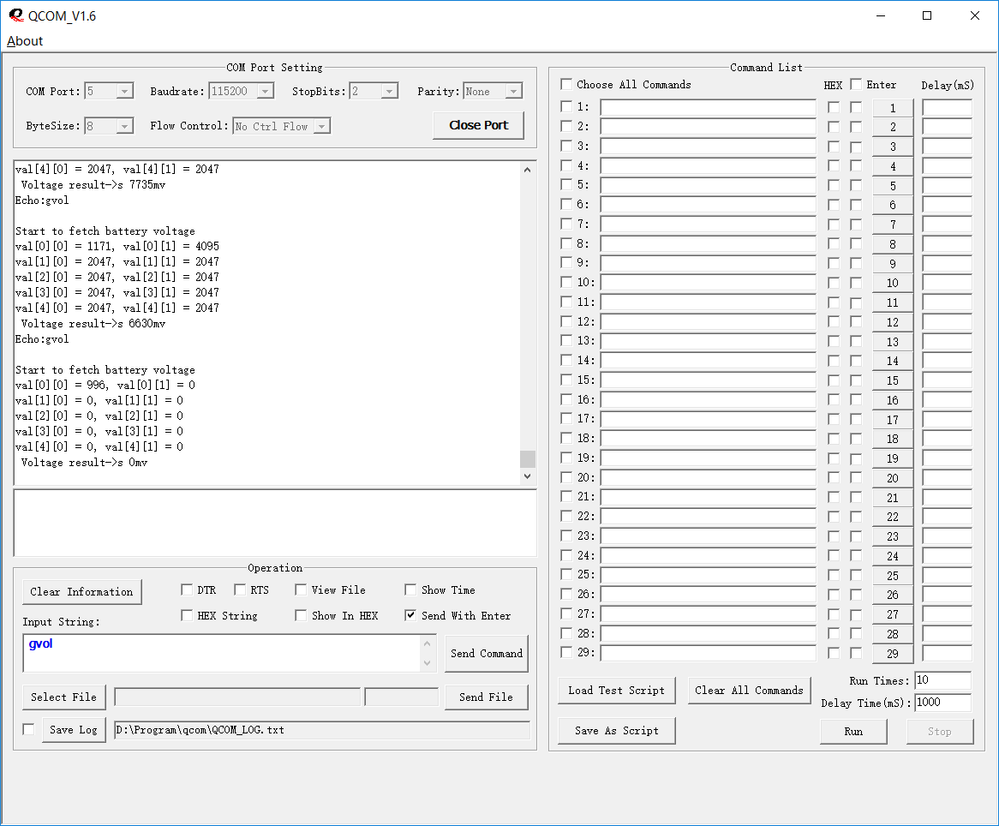

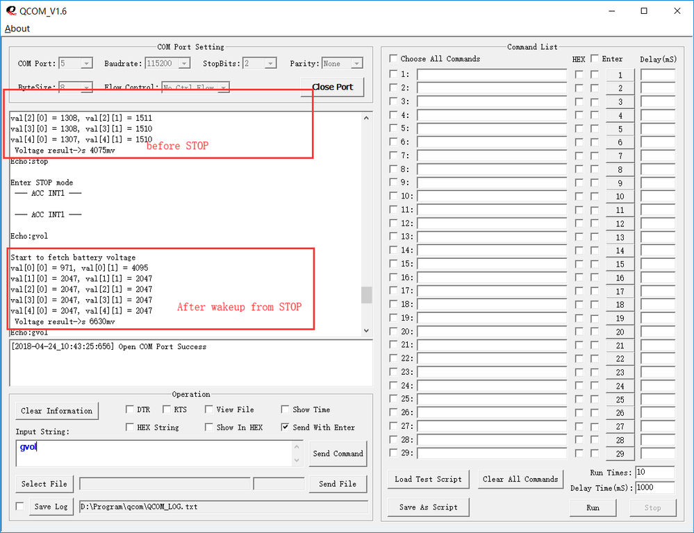

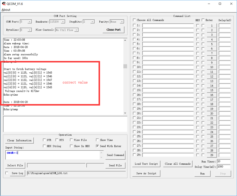

I'm using STM32L071RBT6 MCU, encounter a strange issue. when MCU power on, using ADC channel 0 to monitor external battery voltage, the result is OK. but once system waked up from STOP mode, ADC converter behavior is abnormal, the sampling value random varied from 0 ~ 2000. following is my STOP method, can give me some hint?

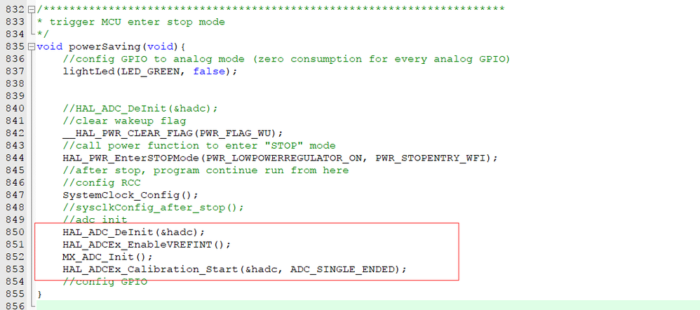

* trigger MCU enter stop mode
void powerSaving(void){
//config GPIO to analog mode (zero consumption for every analog GPIO)
lightLed(LED_GREEN, false);
//HAL_ADC_DeInit(&hadc);
//clear wakeup flag
__HAL_PWR_CLEAR_FLAG(PWR_FLAG_WU);
//call power function to enter ''STOP'' mode
HAL_PWR_EnterSTOPMode(PWR_LOWPOWERREGULATOR_ON, PWR_STOPENTRY_WFI);
//after stop, program continue run from here
//config RCC
SystemClock_Config();
//sysclkConfig_after_stop();
//adc init
MX_ADC_Init();
HAL_ADCEx_Calibration_Start(&hadc, ADC_SINGLE_ENDED);
//config GPIO

Max, thanks for your reply, according to your suggestion, I add HAL_ADCEx_EnableVREFINT() after system wakeup, unfortunately, problem still exist.

TJ, yes, every wakeup from stop, I will do a ADC calibration, is this wrong?
