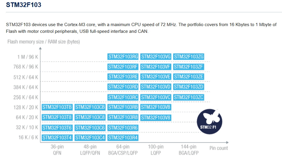

I usually use look into data sheet:
see figure 5.
I think 07 in this case is a device type - no general rule

2018-02-27 11:29 PM
One can see some patterns here - see at the columns - R for 64-pin, V for 100-pin, etc. Rows also seem to have meaning for this F1 line.
