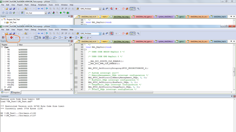

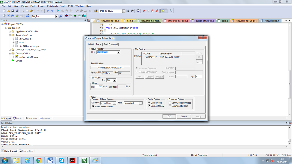

i put
32.678khz in my custom hardware
scenario is my hardware is connect to st link v2 debugger
i generate code trough Cubemax and open in keil 5
Debugger is is deted in keil
But Code is not running.

Also the ST-LINK firmware looks to be super old, consider updating that.

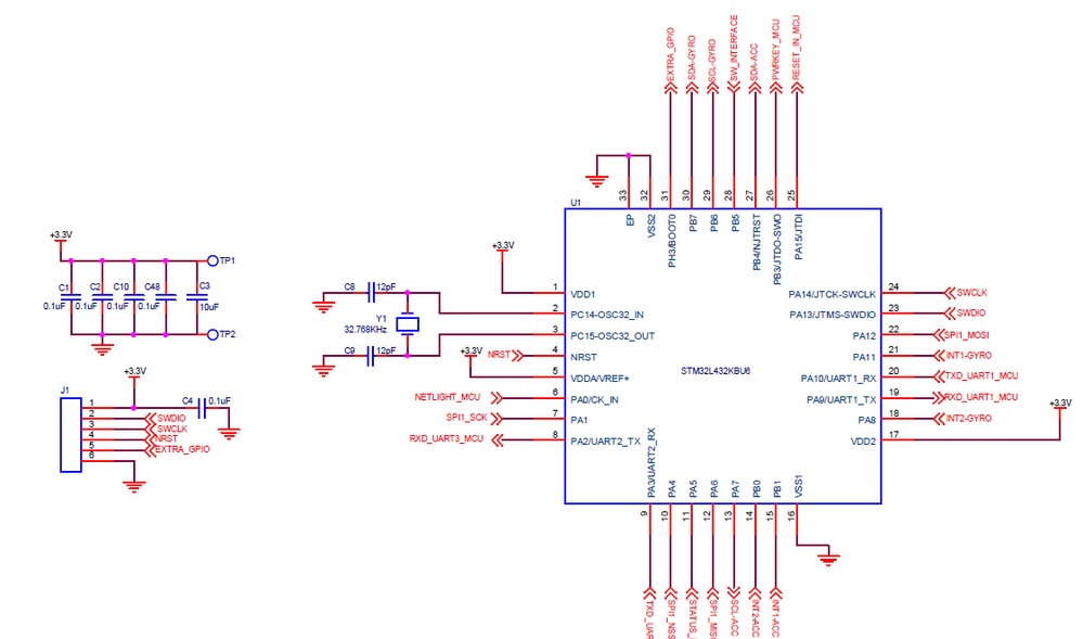

2018-02-27 6:46 AM
Hi Dear
Thanks for Reply me
please find schismatic of controller broad
give me answer ASAP
2018-02-27 7:05 AM
ASAP only works if you're paying the freight costs.
The 12pF C8/C9 seems awfully high, do you have the specs for the crystal you chose and the computations from the STM32 Crystal App note to support that choice?
The STM32's generally do a lot better with 32.768 KHz 6-7pF crystals, and a pair of 2.7pF caps, but that's usually off the OSC32 pins.
I would also pull BOOT0/PH3 low, with perhaps a 10K or 47K
Again make a project using the MSI clock the part starts with and get that working, then move to the crystal reviewing the code that starts it, making sure it starts, and exporting it via the MCO pin so you can confirm it is oscillating properly.
