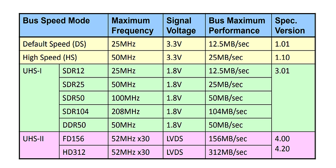

+ without external low voltage driver , speed is limited to 25MB/s with SDHC cards.
2022-09-17 8:04 AM
All MicroSD cards were supposed to be clockable at 50 MHz, since inception. Likely needs an aware/attentive design on the host side. Certainly a lot that can get into the 60's and beyond without exotic drive modes/levels.

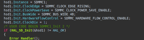

SDIO is not a simple serial data line, is more a complex bus controller you connect to a card; so at first there is some communication about the capabilities of each other, then the controller decides, what mode should be used - and this depends on its implementation. (and on errors - see F407 errata sheet ! hardware flow not working...)
on H743 init to 4 bit mode is at start: (100MHz SDMMC-clock, divide: 1 )
