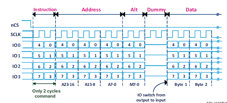

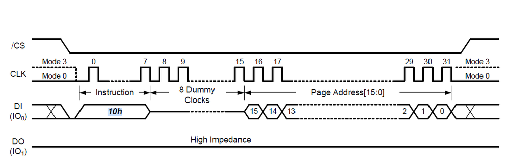

I am working on Serial NAND Flash (Winbond W25Nxx) communication with H747 microcontroller. I'm having a problem with the Serial NAND Flash I have. I think this issue is related to QuadSPI structure.
Reading sequence in quad I/O
Serial NAND Flash command instruction example
How can I send dummy data in QuadSPI Structure before Page Address? Has anyone had problems with this issue before? I know I can throw it back-to-back with SPI but I have no idea how to do something with QuadSPI build.
Say your address is 24-bits wide and not 16-bits..
