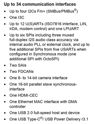

Just look at the general description of a cpu (or soc) , especially whats written under "communication interfaces " , then you can see, what is there : (on H563 , as example here)
So here the " One 16-bit parallel slave synchronous- interface " could be useful for your idea.
