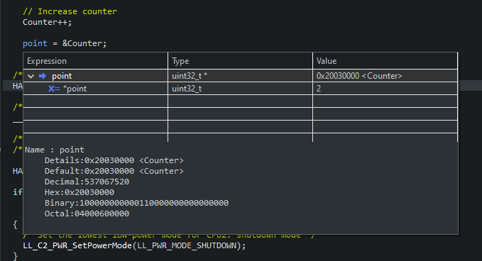

I made a clean example from the example project PWR_STANDBY_RTC

}And it do not preserve the Counter value !!
If I check the Counter address, I can see that it is within the SRAM2A

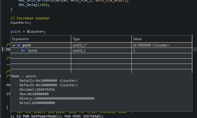

Okay this is wired..
I have been adding this to my linker script, always been and it has worked for all STM32L4 variants I have used before.
Adding RAM2 (here I have been testing the mirror address of the SRAM2A)

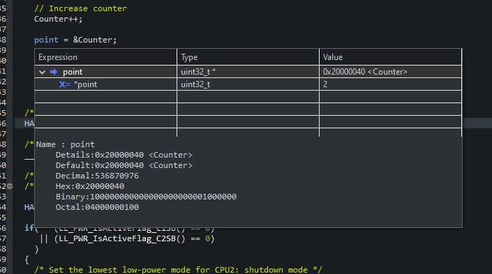

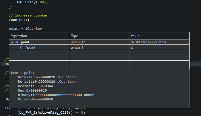

I have played around with the RAM_SHARED and RAM2 address and length, and I found a strange thing.
I accidentally used an ref that I did remove in the linker script.
So I had static __attribute__((section(".sram2"))) uint32_t Counter;
.sram2 do not exist.
But I it worked, the led starting to increase blinking for each iteration, So the variable was preserved!!.
Checking the variable address showed in the beginning of SRAM1
But if I changed the variable declaration to static uint32_t Counter;
then it did not work, it did not preserve the value
And the address was just a few bytes from the address when it worked !!
And then I also tested the mirror address for SRAM2A
And that did not work
I am going crazy here :loudly_crying_face:
