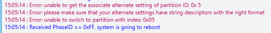

I went through the example firmware you mentioned and tried to implement the same approach. I followed the example structure and updated the TSV file. I did not add any additional OpenBootloader implementation in my project, similar to the example. I only updated the TSV file for my application.
However, I am not sure if my approach is correct or aligned with the intended workflow in the example.
The files below were copied directly from the example and placed in my working directory:
Updated TSV file (FSBL + Application)
#Opt Id Name Type IP Offset Binary
P 0x1 fsbl-openbl Binary none 0x0 OpenBootloader_STM32N6570-DK-trusted.stm32
P 0x3 fsbl-extfl Binary none 0x0 MX66UW1G45G_STM32N6570-DK-OBL.bin
P 0x4 fsbl-extflash Binary nor0 0x0000000 my_app_FSBL.bin
P 0x4 fsbl-app Binary nor0 0x0100000 my_app_Appli.bin
In this case, I am not able to flash, and STM32CubeProgrammer shows an error:

As explained in readme, the example shared uses BootROM, OpenBootloader and External Loader to program NOR flash.
For your final product, the FSBL must include the USB capability if you want field updates without ST-LINK.
The OpenBootloader itself does not need to be unchanged, but your FSBL must provide equivalent USB flashing support and external flash access.
After provisioning, the board must boot from external NOR mode for the FSBL/application to run.
