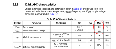

Here a snipped from a datasheet of another STM32 - I don't have nor use a H7 :
Check the respective section in the datasheet of your MCU variant.
And check for footnotes like this :
The term "5V-tolerant" does not mean "operating properly with 5V applied".
And analog pins are explicitely exempt anyway.

Datasheet says V_AIN <= V_Ref+ <= V_DDA <=3.6V.
