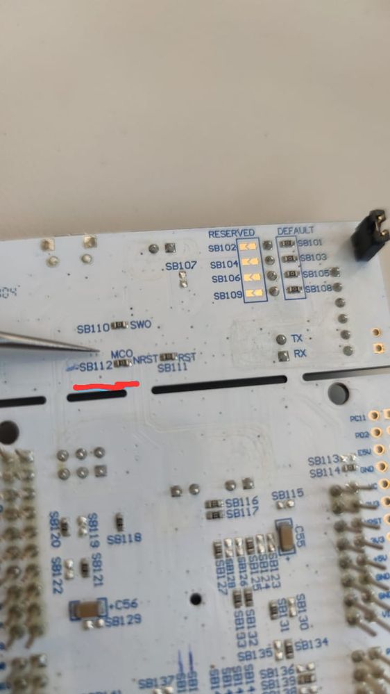

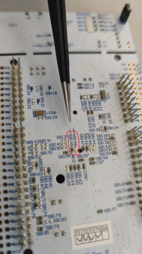

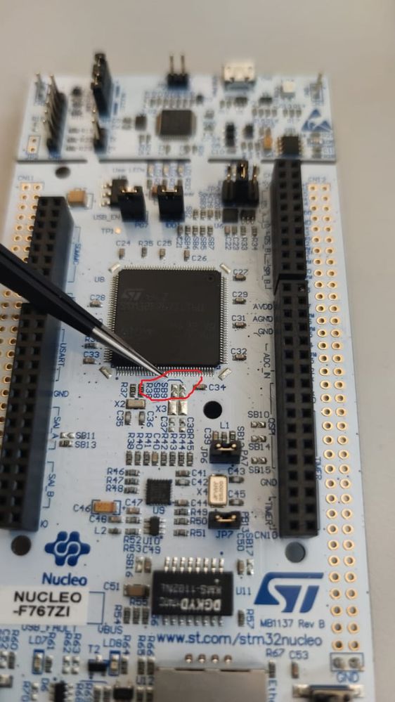

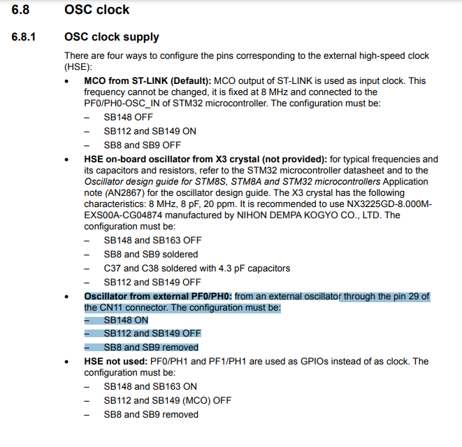

2021-12-16 3:31 AM
I have a Stm32f091rc and 2 F767zi nucleo board. I want to use the f091rc as external clock source. (MCO)
As you see in data sheet it is written I need to remove jumpers SB112 and SB149 and solder a jumper on SB148. It is written also : SB8 and SB9 removed. What does it mean? there is nothing on SB8 and SB9.
