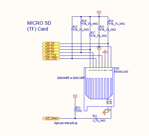

HW configure is seen in this image:
using 1 wire SDIO with this configuration everything works well.
using 4 wire SDIO we I get an CRC fail inside the HAL_SD_ReadBlocks function .

Sorry not a CubeMX adherent.
I have SDMMC/FATFS working on several of the H7 NUCLEO boards, not sure I've ported it to the H723 board, but I do have one.
Electrically the 4-bit mode is a lot less forgiving, but if the socket/wiring has been tested/proven elsewhere it should work here.
Double check the TRANSCEIVER is not used/enabled in the H7 driver code.

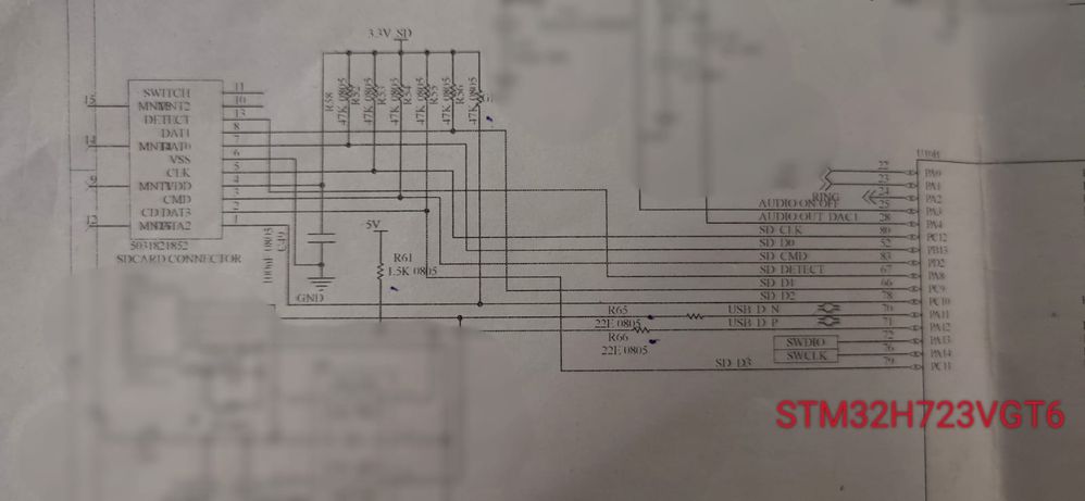

i have also facing same issue with my project,
my task to run sd card(ver 2.0) with STM32H723VGT6 Micro(100 Pins) to audio record and play back purpose!
kindly please confirm/share related connection diagram/exact schematic /related reference.

all above pins have externally pull up ,is it correct connection?
2023-01-04 10:07 AM
The schematic in the top post looks consistent with other working designs.
Yours looks reasonable too. Probably would skip the pull-up on the CLK.
Watch for line lengths, keep them consistent, avoid stubs. The PCB implementation is important.
AF12 is the Alternate Function which is different/special compared to other pins, watch that in the pin level configuration. And the GPIO banks whose clocks are enabled.
For short traces, I'd probably look to reduce the SPEEDR setting, if the slew rate is too aggressive then the lines will likely ring. Above 33 MHz clocking, I'd probably consider 27/33R series resistors.
Do some debugging, understand what specifically is failing, look at status/error returns.
Debug the DISKIO layer first. Make sure the READ functionality is solid first.
2023-01-04 10:08 AM
Is 3.3V SD gated via PA7 SD_ENB ??
