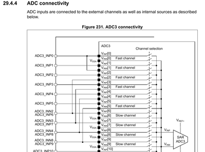

>CubeMX doesn't clearly indicate which ADC channels are direct
Right, you have to look in rm for your cpu, to see this in detail:
CubeMX cannot know, what you want to connect and what real resolution will be possible then,
vs what you expect. It shows just, what can be used/connected to a pin .
Whether this makes sense for the intended design , or not, is your decision. :)
