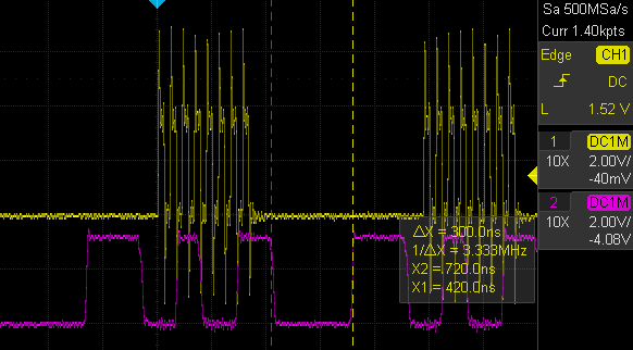

I took your function and got it running on an 'F429 Disco at 180MHz system clock. And inserted the pin toggling (used the green LED on the Disco):

}(Yes, here I have an even worse probe than you). Yellow is SCK, purple is the green LED, timebase is 200ns/div. So we start with a cca 220ns (40 cyc) positive pulse which indicates the write to SPI->DR, then during transmission we see the alternating polling of Tx and Rx flags (even if TXE is set after the first SCK pulse, there's no more write to SPI->DR due to txallowed being zero), cca 100 ns each, maybe 15-20cyc. After the last SCK pulse, RXNE gets set, that's why we see a long negative pulse where SPI->DR gets read (cca 300ns, 55cyc); as that sets txallowed, a long positive pulse for SPI->DR write follows (again cca 220ns/40cyc).
The compiler decided to do the green LED GPIO_BSRR writes from registers, so those are truly single-cycle and don't impact the total timing too much.
Following is disasm of the portion where RXNE is tested and SPI->DR written, that together with the test at the beginning of loop lasts cca 300ns/55cyc, it's around 25 instructions. Given there are two reads from the slow APB bus included (amounting to perhaps two dozens of cycles), I think this is entirely justified (btw. all memory reads/writes go from/to the CCM, so they *are* single-cycle):

8000378: 6185 str r5, [r0, #24] // and here we set LED up again> And it would not surprise me if nobody had discovered this before, because the result works and if stuff works, nobody will be checking it with a scope
