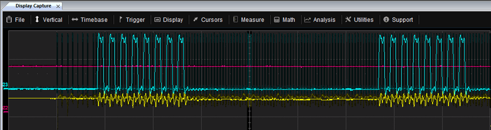

2022-01-12 8:27 AM
OK here we go. Spot on, the clock bursts have gaps of exactly 2/3 of the time.
The zoomed X axis is 200ns/div.
The waveform is ringing because I am probing the board without decent scope grounds.
Ignore other traces - they are irrelevant. Just the clock.
So what the hell is it waiting for during those 800ns? 2 whole byte periods.

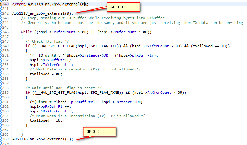

To recap, this is the code

2022-01-12 8:33 AM
As we've been saying all along, the code cannot keep up with the data rate. Use DMA, higher optimization settings, or your own code to overcome the issue.
800ns is not a ton of time in terms of cycles. Did you specify your CPU clock rate anywhere in this post?

> No, there is something in that code which is waiting exactly two byte periods.
Or executing code takes exactly two byte.
Have you read out and checked the SPI registers content? Do you have interrupts enabled on that SPI?

2022-01-12 9:06 AM
The mcu does not work out of source code.
Read out and check the relevant registers.
Write a simple test program which does NOTHING but dump 512 bytes through SPI. It does not need to be meaningful for the sFLASH itself, you just observe the bus/timing.
Insert the pin toggling into places within the Tx/Rx routine to see progress there.
Ultimately you want to use DMA. Not that it's without problems.
