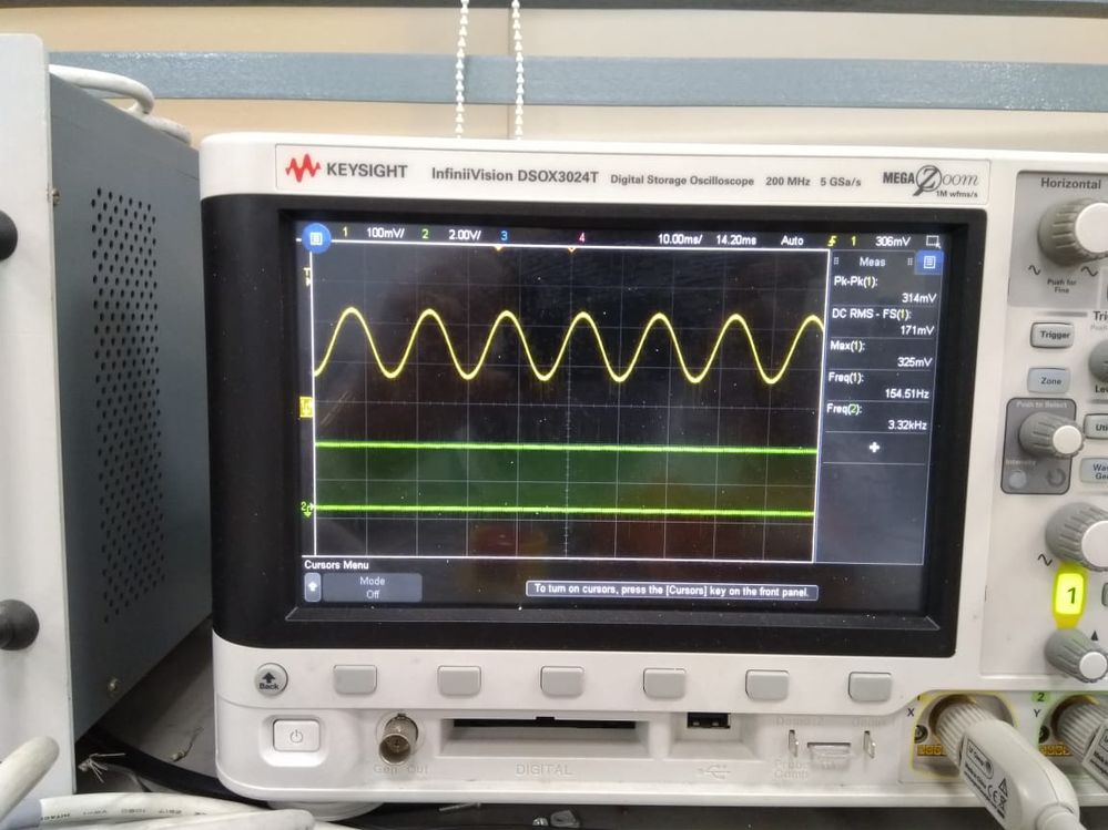

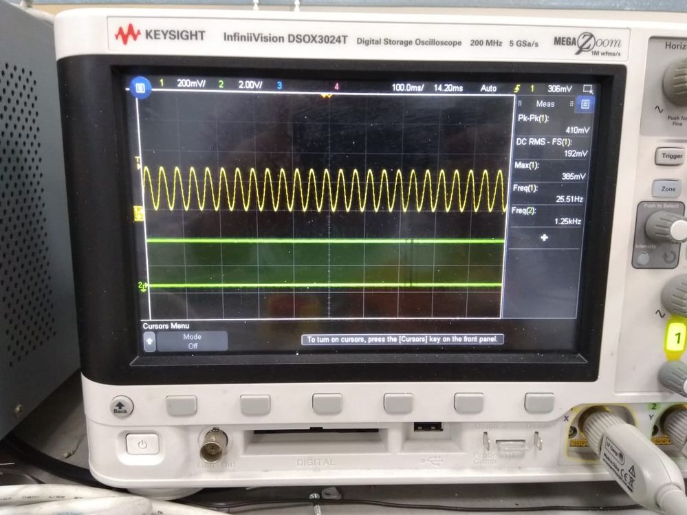

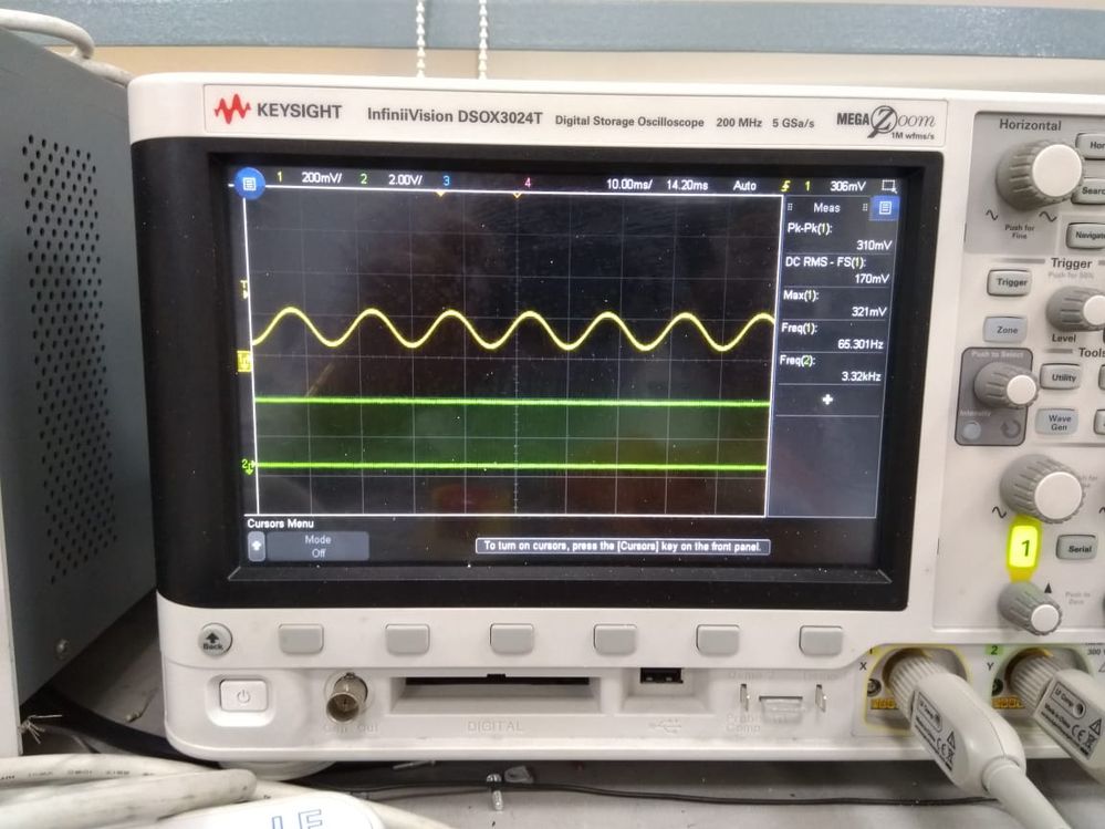

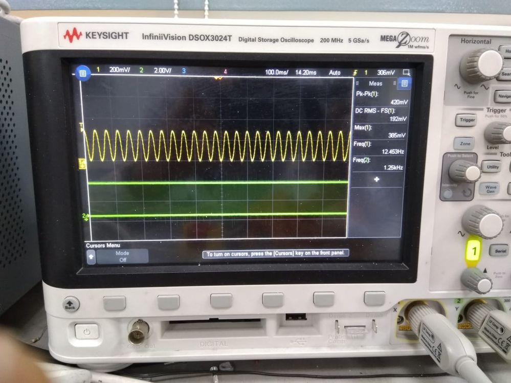

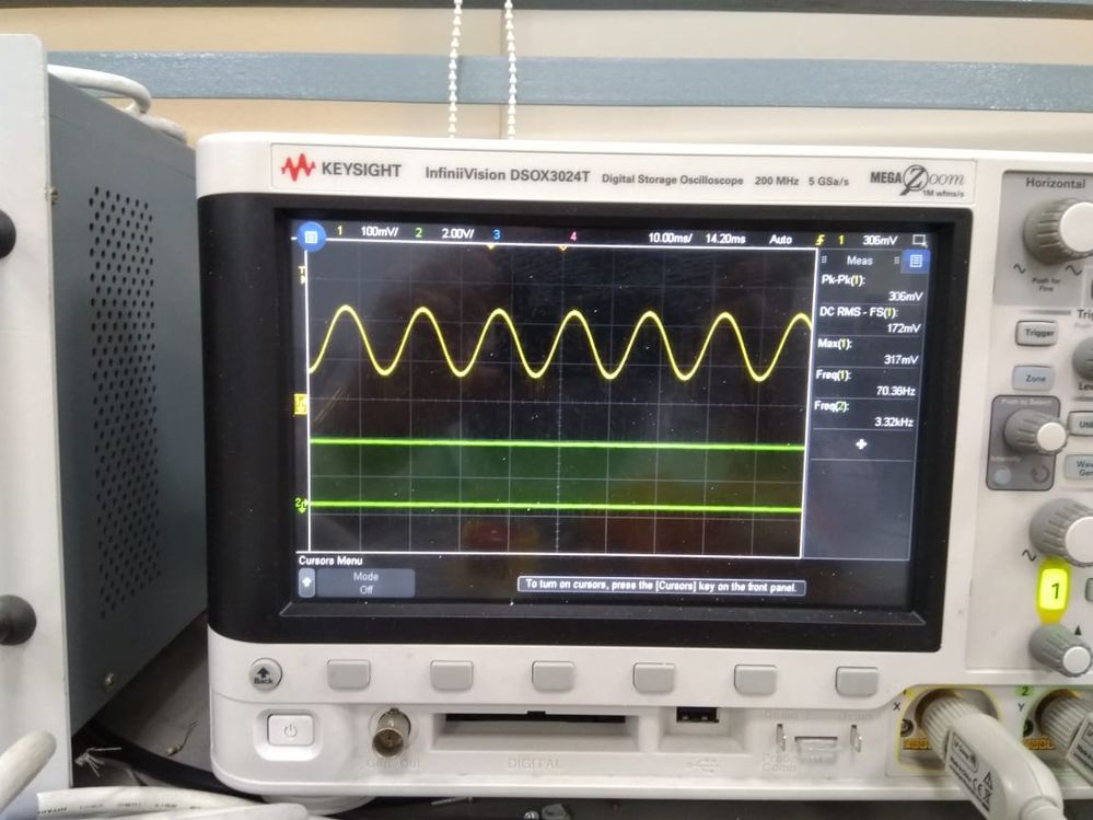

2020-08-12 4:37 AM
@TDK
Here i have attached some pictures of CRO which is showing that ISR calling freq is stable but generated sine wave freq is varying.
i have tested program first with RCR=15 i.e. at every 16(15+1) update interrupt isr will be called
second with RCR=5 i.e. at every 6(5+1) update interrupt isr will be called
both case shows that sine wave freq is not stable but isr routine freq is stable.
i have took picture of just one sine wave out of 3 phase.
i have tried timer in up counting mode instead of center aligned mode but situation remains same.
2020-08-12 6:20 AM
Hmm, I'm not sure. If ISR() is getting called at a constant rate I can't see any reason why the sine wave frequency would be changing.
