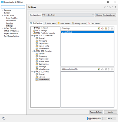

So I have enabled the flag as suggested by the warning:
After adding this flag, I can no longer compile my project as I am getting the following errors:
