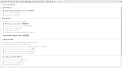

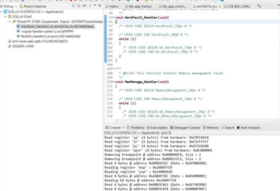

Hello all I am facing a issue my program works however when is executes this part it runs only once after that it ran into hard fault. I have attached the snap of structure part of code which cause it and also exception observation please let me know if you do have any suggestion.

On debugging Hard Faults - both Cortex-M in general, and STM32 in particular:
and please scroll to the top of that thread for how to properly post source code - not as images ...

Need to read this article on how to debug the hard fault.

Identify the processor
Show the registers
Show the code (disassembly) at the failure
Reading something from a bad pointer? Misaligned?
https://github.com/cturvey/RandomNinjaChef/blob/main/KeilHardFault.c
I perhaps need to migrate this to GNU/GCC variant, and g_pfnVectors
