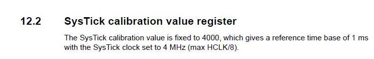

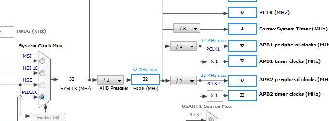

In the reference manual for the STM32L0 #12.2 it says about the Systick clock to be set to 4MHz, which is the Cortex System Timer in Cubemx. 2 images shown below.
So I set this to 4MHz and measured the HAL_Delay(1); but it measured as 15ms on a scope, instead of 1ms.

I think there is a misunderstanding on your side.
The ref manual means here that this SysTick calibration value (4000) is calibrated for a system clock of 4MHz.
4MHz / 4000 = 1kHz => 1ms
SysTick itself is just a 24-bit counter that works on the core clock.
If the SysTick is not what you expect, the core clock is most probably not what you think.
Don't know (or care) what Cube does here, sorry.
2017-10-17 3:30 AM
The systick calibration value is content of a read-only register, STK_CALIB, and is just a hint (btw. if it's really 4000
https://community.st.com/0D50X00009XkaB4SAJ
, but I am not surprised and it is really of no importance). You can set the systick to any division rate in STK_RVR. Read chapter 4.4. of PM0Cube surely has some mechanism to set this, but I don't Cube. Cube has some documentation so you can try to find it there. Cube is open source so you can look it up. And you can always look in the debugger at the actual STK_RVR setting.
But I repeat, with a 1ms granularity primary source, 1-tick loopdelay may last anywhere between 0 and 1ms. Try a longer one and divide the result for more precision.
2017-10-17 3:35 AM
That would be true, wouldn't systick count from (reload-value -1), but it does not.
When enabled, the timer counts down from the reload value to zero, reloads (wraps to) the
value in the SYST_RVR on the next clock cycle, then decrements on subsequent clockcycles.To generate a multi-shot timer with a period of N processor clock cycles, use a RELOAD
value of N-1. For example, if the SysTick interrupt is required every 100 clock pulses, setRELOAD to 99.I ranted already, see link in my previous post.
2017-10-17 4:22 AM
You are correct.
But with 15ms instead of 1ms, there is something else substantially wrong.
As said, +1.
I used to have such large SysTick 'deviations' when the clock setup was incorrect.
Which should be easy to find.
