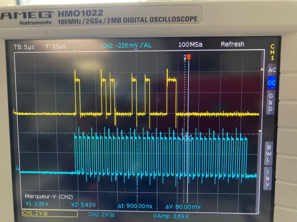

Have you used a logic analyser to see what's happening on the wires?
2024-09-19 4:39 AM
Thank you for responding to me,
I already address the issue with manual delays. I removed the manual delays.
I also an Hardware NSS Signal: Output Signal for the Master and Input Signal for the Slave. But this also did not resolve the problem.
I use an oscilloscope to analyze the data = "ABC", it looks correct for me
2024-09-19 4:55 AM
Doesn't your scope have a proper facility to capture screen shots - thus avoiding that glare, etc?
@Dreamer3D wrote:I also an Hardware NSS Signal: Output Signal for the Master and Input Signal for the Slave. But this also did not resolve the problem.
That's not the right right way to use NSS:

2024-09-19 5:49 AM
You really need to get a logic analyser on the wires to see what's actually being transferred
