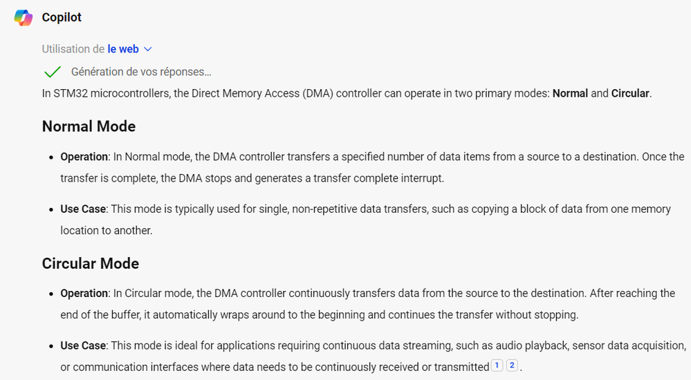

2024-09-25 2:24 AM
It's finnaly some experimental work and ChatGPT who resolve the problem
look bellow at this response that ChatGPT gave me.
Apparently, the circular mode is perfect for continous data transfer
