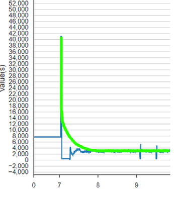

This period value is used for the calculation of SVPWM (Space Vector Pulse Width Modulation). Using this value, we are calculating the angle within sector. While debugging, we found that the motor vibrates slightly during the motor startup, So we are getting improper period values.
The blue line is the period value, and green is how it should have looked according to motor speed. As in this image, due to vibrations during the initial stage, we get multiple interrupts, this messing up the period values.

Sorry for the bad composition of the earlier post. I am making a custom motor control program.
The problem I am facing is that due to the motor vibration at start, hall interrupts are generated in quick successions. So, the period value is very low. We are calculating the electrical angle based on this period value, but since it is wrong, the whole SVPWM calculation is getting messed up.

2024-01-29 5:25 AM
I have added RC filter on the hall signal lines, and have tested them on DSO, there is no noise present on the signals which could cause multiple interrupts in my case.
