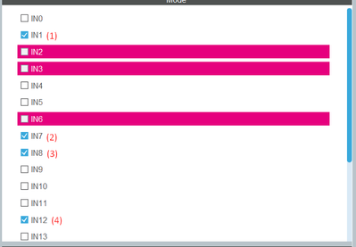

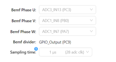

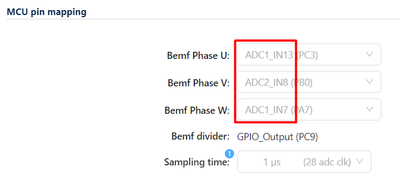

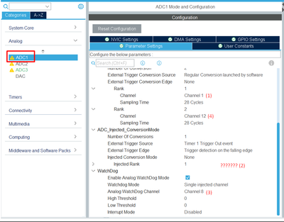

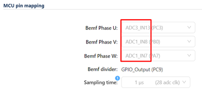

I hope you’re doing well. I wanted to revisit this issue mentioned in the Release Notes for X-Cube-MCSDK 6.4.1, as I came across some additional information that might be relevant. First, I’d like to thank you and your team for addressing this matter.
After upgrading to X-Cube-MCSDK 6.4.1, I noticed that the issue hasn’t been completely resolved. Specifically, when using the hardware Nucleo-F446RE, X-Nucleo-IHM07M1, and motor A2212 13T, I observed the following:
Although I am working with the same hardware setup, every time I create a new project, the MCU pin mapping for the BEMF seems to differ, and it is not consistent.
While this is not a significant issue for me, the bigger concern is that after generating the project and opening it in CubeMX, I noticed that the setup for the 1-channel ADC is missing. Here's an example:
My question is whether the missing ADC channel setup could affect the overall functionality of the 6-step BLDC motor control code. I ask because I noticed that the 6-step firmware uses Analog Watchdog Mode to monitor the BEMF and check if it crosses Vdc/2.
Looking forward to hearing your thoughts on this.
