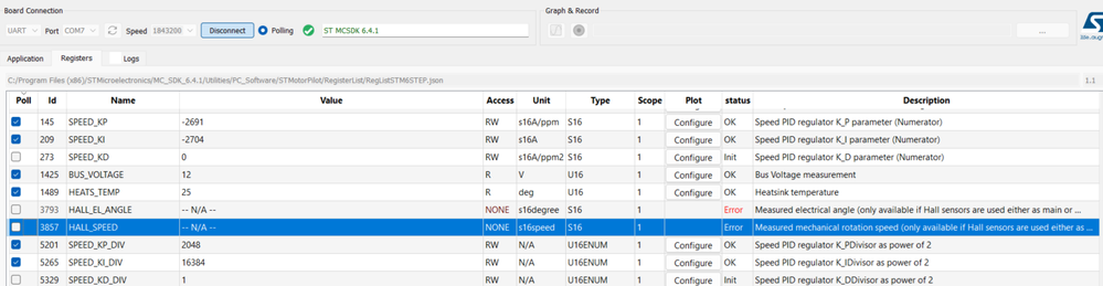

However, when I try to start the motor, it needs a manual push to get going and then it immediately ramps up to maximum speed. Also, I don’t see any speed feedback on the Motor Pilot, and I can’t change the target speed. If I try enabling polling of HALL_SPEED or HALL_EL_ANGLE from the registers, I get the following log error:
[WARNING] - MotorControlRegistersBank: Accessing register [3857] HALL_SPEED resulted in error[5]. Changing register's access accordingly to avoid getting this error again

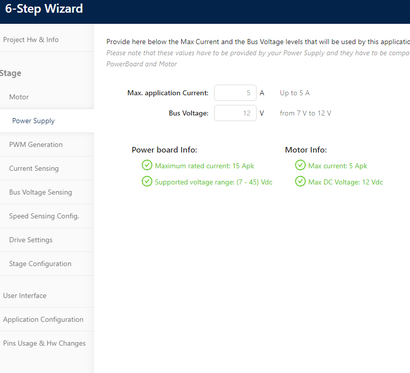

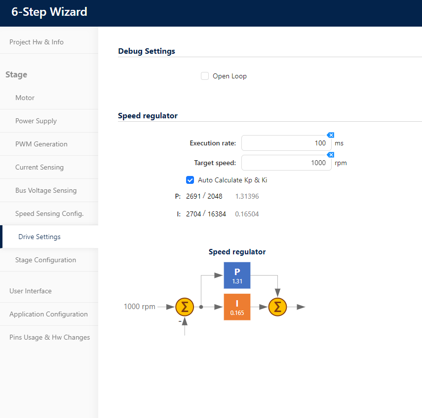

I’ve attached some screenshots. Thanks in advance to anyone who can take the time to help.

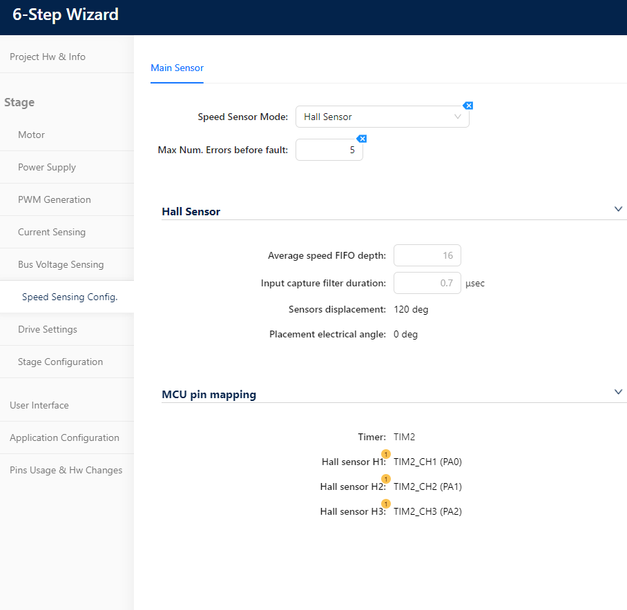

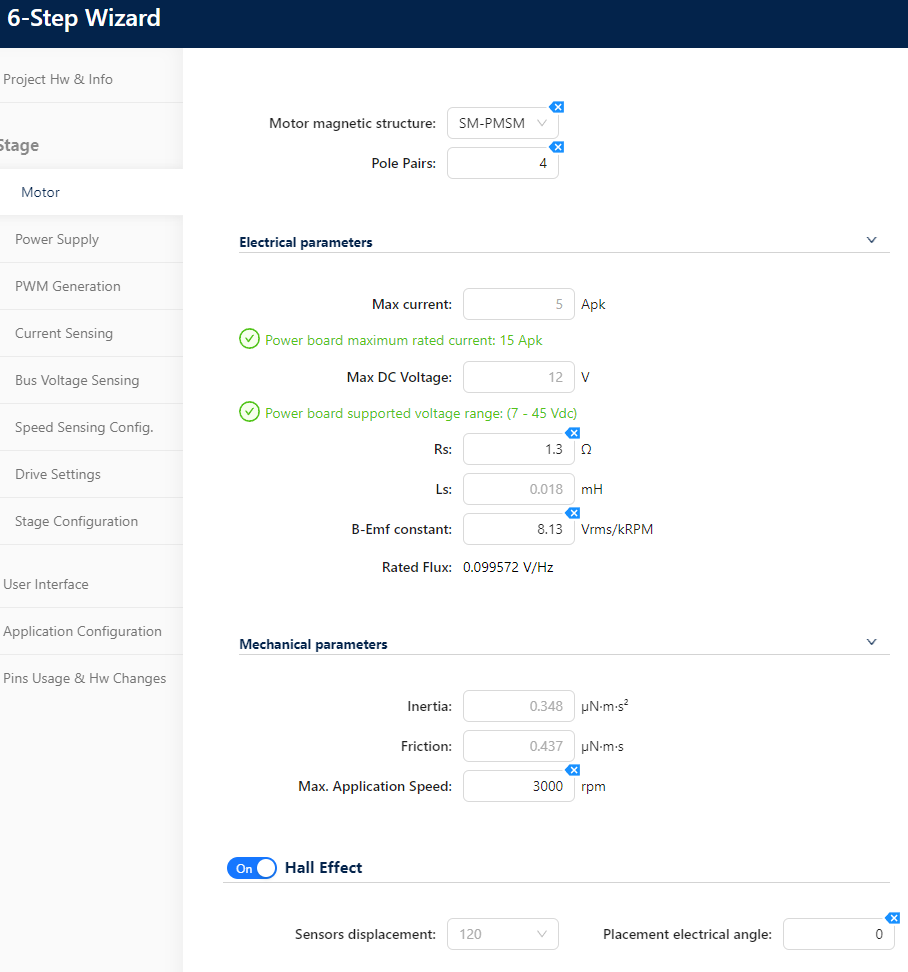

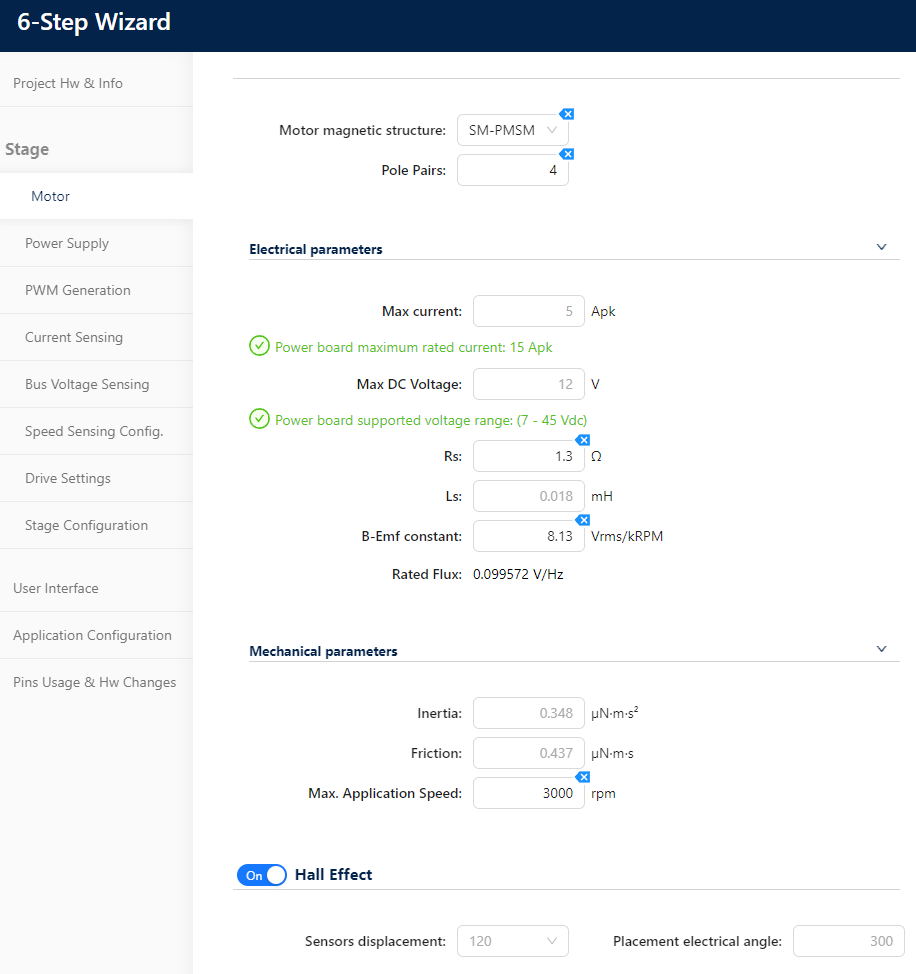

There is a parameter missing in your project for Hall sensing. It is the placement electrical angle. Without this parameter, the firmware will not function properly. Additionally, the two parameters HALL_SPEED and HALL_EL_ANGLE are not managed by the firmware for the 6-step algorithm. Therefore, they should not be available in the Motor Pilot, sorry for this inconvenient.
